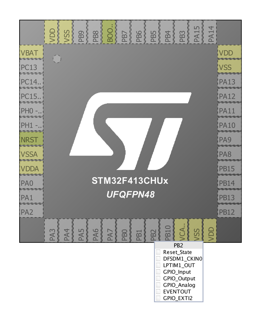

I recently had a problem in one of our designs that was caused by assigning a GPIO with an external pull-up to PB2 on an STM32F413. It turns out that this pin has the additional function of being BOOT1, so the pullup caused the MCU to be unable to enter the system bootloader mode. I use CubeMX to plan my pin assignments, and this additional function isn't indicated anywhere in the user interface. Yes, I probably should have caught this by cross-referencing the report with the datasheet, but this is definitely an area where CubeMX should be able to help me out.

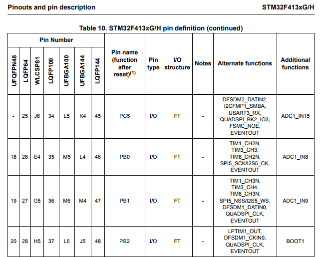

,Regarding the pinout config, the data sheet is our reference. If you have a look to the data sheet for the STM32F413 (
http://www.st.com/en/microcontrollers/stm32f413vh.html
), the PB2 pin is named PB2 and has BOOT1 as additional functions :So, the name of this pin is correct on CubeMX and you can find the information of where Boot1 is mapped with the data sheet.

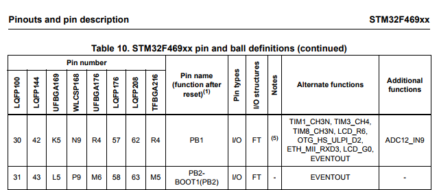

For other MCUs as STM32F469, the name of the PB2 is PB2_BOOT1 as seen in the data sheet :
I hope I have answered your question.

‎2018-03-06 11:58 AM
No, this absolutely does not address the issue. Look at this screenshot from CubeMX:
