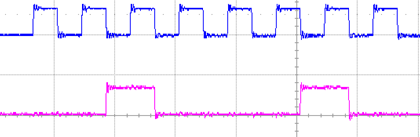

I am using the STM32F4 as an SPI slave.
The signal is comming with LSB first, CPOL=0, CPHA=0. See image below, which shows the reception of 0x44: 0690X00000604mTQAQ.png Neverthe less, I seem to have to set CPOL=1, CPHA=1 to receive it correctly! With any other configuration, it gets parsed wrong. What is wrong? Below my configuration (as generated by STM32CubeMX:

Posted on October 01, 2015 at 15:33
Hi CaCO3,
No all configurations give you correct data display, you have to respect this condition
''The idle state of SCK must correspond to the polarity selected in the SPI_CR1 register (by pulling up SCK if CPOL=1 or pulling down SCK if CPOL=0).''
as indicated in the page 869 ( Clock phase and clock polarity) of RM0090.
-Shahrzad-
caco3
Posted on October 05, 2015 at 09:24
I did some further tests. It seems that the inputs are very sensitive to noise. If I shield the wires better and add a filter, it works much better.
Additionally, If I use a CS input (SPI_NSS_HARD_INPUT), it works without a problem.
