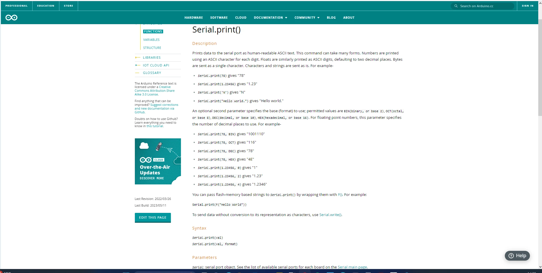

Hi, i converting/translating an arduino code to STM32. Do someone know a similar function in STM32 Cube as arduino "serial.write" and "serial.print"?
I know that the function "HAL_UART_Transmit(&huart,Data, size, 100)" works simalarly as serial.write. Do someone know how to make your own "serial.print"? if Cube IDE has a similair function, it would be also good for me.
In the pictures you can find the explanation of arduino "serial.write" and "serial.print.
To retain about arduino serial.print is the following:
  • Serial.print(78) gives "78"
  • Serial.print(1.23456) gives "1.23"
  • Serial.print('N') gives "N"
  • Serial.print("Hello world.") gives "Hello world."

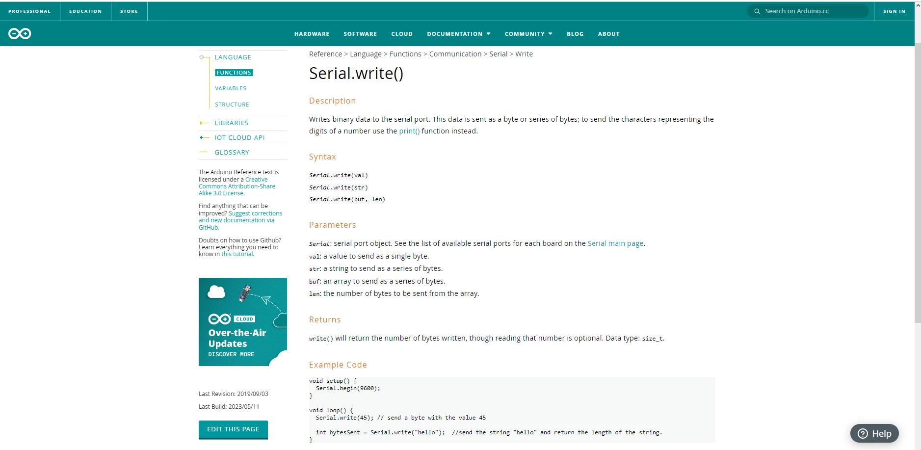

To retain about arduino serial.write is the following:
Serial.write(78); // send a byte with the value 78, so i think serial.write(78) gives "N" --> "N" is the ASCI character linked on decimal 78.
