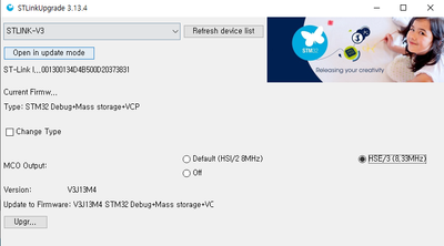

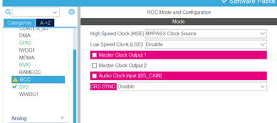

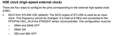

I want to use the HSE of the NUCLEO-H743ZI2 development board. I tried to set it up according to the instructions in the user manual using MCO from STLINK-V3E.
Here's my setup:
However, when I checked STLinkUpgrade, I found that the HSE is set to 8.33MHz.

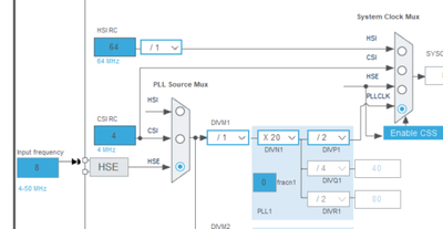

In the clock configuration, should I set the input frequency of HSE to 8Hz or 8.33MHz?
Thank you very much for your guidance.

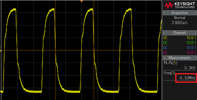

Indeed, you need to set HSE source of your MCU to 8.33MHz as it is a source coming from HSE of the ST-LinkV3 module divided by 3: 25MHz/3 = 8.33MHz.
This is an oscilloscope screenshot probing ST-LINKV3 MCO output and showing the 8.33MHz:
In STLINK V2 = MCO output frequency is 8MHz.
A very good question))
Many examples assume 8 MHz clock so you can be tempted to use this. But note that the 8 MHz comes from internal oscillator (HSI), which is imprecise. And if you want a precise crystal (HSE) - you get 8.3(3) Mhz, which comes from 25 Mhz divided by 3.

I'd set HSE_VALUE to 8333333 so speeds and baud rates are correct.
You could use the 8 MHz HSI sourced clock from the ST-LINK, but that would not be good for CAN /USB peripheral

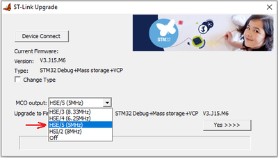

An update + good news:
The latest ST-LINKV3 firmware version V3J14M5B5 supports a MCO output frequency of 5MHz (25MHz/5) which is an integer value (HSE as source).
So please use ST-LinkUpgrade.exe tool (downloadable from here) and select 5MHz as shown below:
