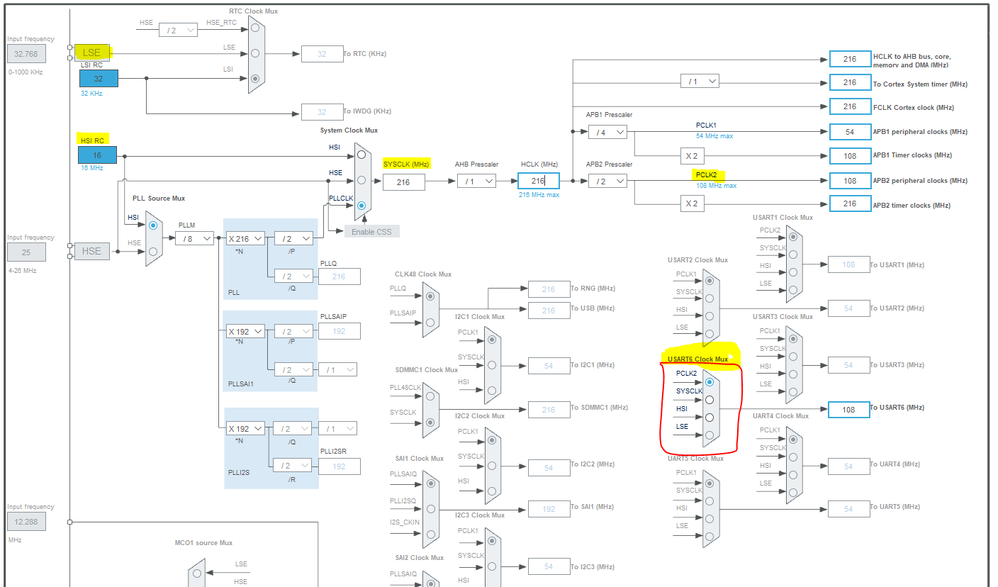

USART peripherals (and some others too) use 2 different clocks, so called kernel clock and interface clock. Interface clock is the one used to access to registers on APB bus while kernel clock is the one generating baudrate.
Specifically for USART6 you can pick one of these clocks: PCLK2, SYSCLK, HSI, LSE. First one is by default and is derived from system clock. If you modify system clock (as you did by modifying PLL), then you modify PCLK2 too. Same goes for SYSCLK. But you can use HSI, High Speed Internal, or Low-Speed-External LSE clock.
Here I would then suggest you to use HSI, 16MHz in this case. You set baudrate BRR register according to your needs and then you can modify interface clock (with PLL) without stopping UART and enabling it back. Effectively you are safe from data loss.
See image below. You can modify kernel clock for USART with RCC registers.
Tilen

You don't need CubeMX to use it, I just took an example to show you how are clocks related.
You did not tell us what drivers you use, but anyway, as said before, RCC block is the one you need to focus to configure any clock, including kernel clocks for IP.
Register DCKCFGR2 in RCC.
Please note that HSI might not be the best source for driving UART baudrate. Please check datasheet for max and min values for HSI oscillator. Best would be to disable UE bit, modify BRR and re-enable UE bit for USART instead.
