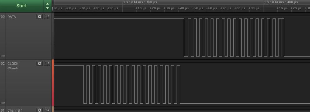

serial data + clock + timer + dma 17 bit
vasilius
Posted on August 03, 2016 at 00:06
Hello

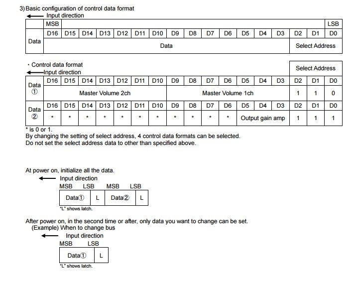

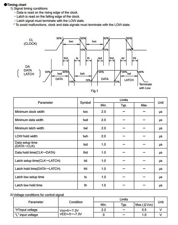

need to implement such a protocol
i need to make solution without interrupts and with DMA
the main idea is send bufer with timer
like here
but cant conigure timer
may be exist better idea than using timer or may be somebody can help to configure timer
thx

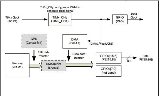

The fact it uses both clock phases, and that the data leads the clock means you need to drive the DMA with one timer channel, and then toggle another channel with delayed phase.
The alternative is to drive the clock as part of the GPIO DMA, at perhaps 4x the bit/clock rate, from a pattern buffer.
waclawek.jan
Posted on August 03, 2016 at 12:19
I would use a timer only to generate clocks - one channel in toggle mode for the clock to the device; other in PWM mode to generate a double-frequency clock, which I would then feed externally to SCK of a SPI, which in turn in slave mode would provide the data, feeding itself through DMA.

need ''mask'' clock also - bcs need only 17 clocks for each bit transfer, and with latch no need clock , need drop down line
for example clock mask in bit ''101010101010101010101010101010101010''+''0''latchbit
data any 17 bit ''101010101010101010101010101010101010''+''1''latchbit
and clock run after data

I'm reasonably sure that you will be able to do this using GPIO and DMA; I've used this approach in an STM32F405 to read a synchronous serial stream on both rising and falling edges.  I didn't try to write to the stream, but I see no reason why it couldn't be done.
I should add that you CAN NOT use DMA1 to do this (on an F4 part, at least) because DMA1 cannot access the entire memory space; the GPIO registers are inaccessible to it.  You can do it with DMA2 though because DMA2 can access the entire memory space; this means you have to use TIM1 or TIM8 because they're the only timers that can interact with DMA2.

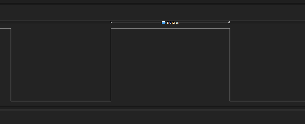

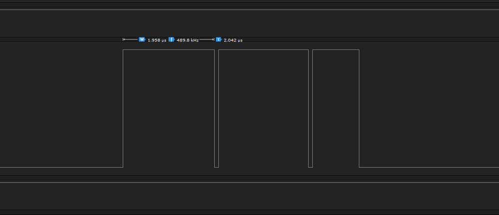

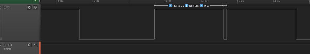

run :
uint32_t buf[4] = {84, 84, 84, 0};
HAL_TIM_PWM_Start_DMA(&htim3, TIM_CHANNEL_3, buf, 4);
0690X00000605QrQAI.png seems like ok, but i need 100% filling
uint32_t buf[4] = {168, 84, 84, 0};
i must see 3usec at HIGH 1usec LOW and 1 usec HIGH but i got : 0690X00000605L9QAI.png try to decreese value
uint32_t buf[4] = {162, 84, 84, 0};
a got 0690X00000605NtQAI.png but its also fake do :
uint32_t buf[4] = {161, 84, 84, 0};
0690X00000605R1QAI.png its looks like OK but its not 100% filled PWM How to get 100% PWM in timer DMA mode? Thx

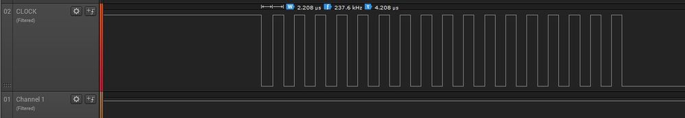

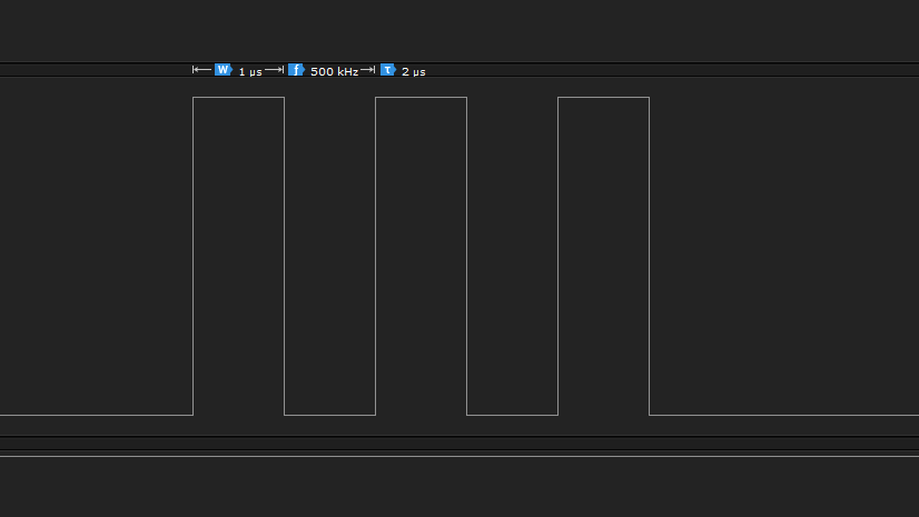

If i run timer in
Output Compare -> mode Toggle on match
uint32_t clk[34] = {167, 0, 167, 0, 167, 0, 167, 0, 167, 0,
167, 0, 167, 169};
HAL_TIM_OC_Start_DMA(&htim3, TIM_CHANNEL_3, clk, 34);

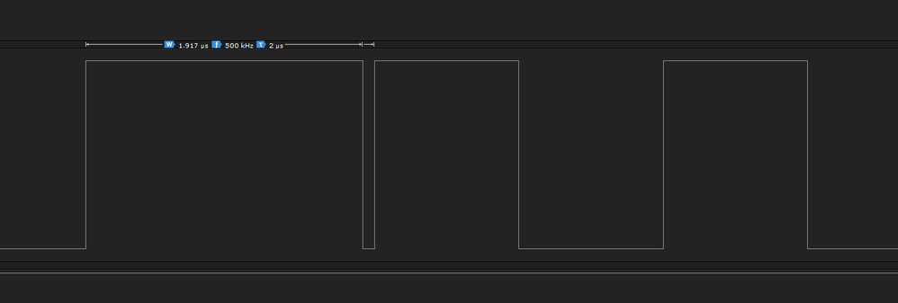

In this mode cant get two HIGH impulses side by side. But for CLK its OK 0690X00000603ASQAY.jpg If i run timer in PWM mode
uint32_t data[35] = { 161, 0, 161, 0, 161, 0, 161, 0, 161, 0,
161, 0, 161, 161, 0};
HAL_TIM_PWM_Start_DMA(&htim3, TIM_CHANNEL_4, data, 35);
i cant get 100% PWM 0690X00000603AXQAY.jpg 0690X00000603BpQAI.jpg But in PWM mode i can make two HIGH impulses - its OK for DATA Also i try to redirect DMA to

Use a timer with multiple OC channels - you must use TIM1 or TIM8 anyway, because of the DMA issue that I've already mentioned. Do not try to use the timer to directly drive the clock signal.
e.g. If TIM1 is clocked at 100MHz, and you want to work at the maximum bus frequency of 250kHz, set PSC = 0, ARR = 400, CCR1 = 100, CCR2 = 200, CCR3 = 300.
For each transmission, construct an array of data and latch bits.  The last latch bit must be '0' and I presume that the others must be all '1'.
Data:  0b10101010101011
Latch: 0b11111111111110
Configure the TIM and DMA to:
Write your data pin to the next data bit value on TIMx update trigger.
Write your clock pin to '1' on TIMx->CH1 trigger.
Write your data pin to the next latch bit value on TIMx->CH2 trigger
Write your clock pin to '0' on TIMx->CH3 trigger
Use bitbanding to target the DMA transfers at particular bits in the data and latch arrays, and the GPIO ports.
