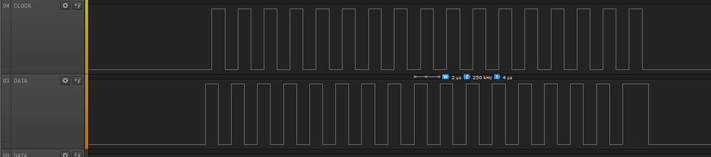

Hello
need to implement such a protocol
i need to make solution without interrupts and with DMA
the main idea is send bufer with timer
like here
but cant conigure timer
may be exist better idea than using timer or may be somebody can help to configure timer
thx

vasilius
Posted on August 06, 2016 at 16:57
Thx to all
__HAL_TIM_DISABLE(&htim8);
__HAL_TIM_DISABLE_DMA(&htim8, TIM_DMA_UPDATE);
HAL_DMA_Start_IT(htim8.hdma[TIM_DMA_ID_UPDATE], (uint32_t)&MASTER_BASE, (uint32_t)&GPIOA->BSRR, 74);
__HAL_TIM_ENABLE_DMA(&htim8, TIM_DMA_UPDATE);
__HAL_TIM_ENABLE(&htim8);
