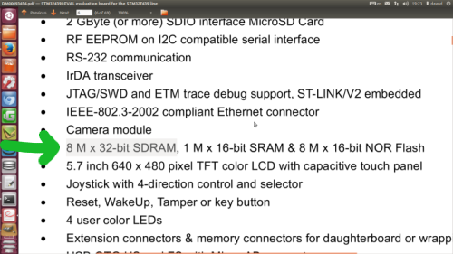

I try find datasheet SDRAM on this board but I can't find it.
I want Row Address Input and Column Address Input .

Posted on October 15, 2014 at 17:58
MT48LC2M32B2 is 2 Meg x 32 (512K x 32 x 4 banks)
but my board is 8 M x 32-bit SDRAM (page 6 from DM00093454.pdf)
where is different?

Posted on October 15, 2014 at 18:41
UM1668 on the schematics states MT48LC4M32B2 which is 1 Meg x 32 x 4 Banks.
What a mess.
Posted on October 16, 2014 at 10:16
It seems that is a typo error in Eval board user Spec (DM00093454.pdf), the correct information should be 8Mbytes SDRAM, 2Meg x 32-Bits.

stdavod
Posted on October 16, 2014 at 13:40
With
my own
eyes
I
saw
the
writing
on the
board
(IS42S32800G =8M x 32bit=2Meg฀ x฀ 32฀ bit฀ x฀ 4฀Banks)
but page 45 on DM00093454.pdf is for MT48LC4M32B2B5-7.
now what can we do?
