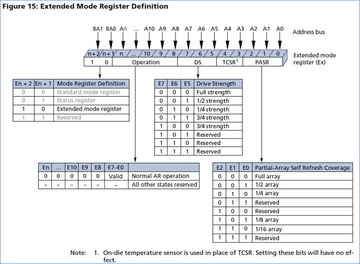

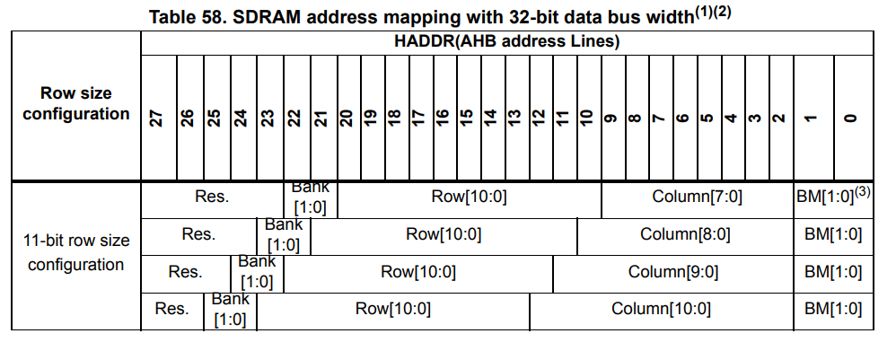

I am using an STM32F769NI with a MT48H16M32LFB5-6 SDRAM chip, everything works fine. we are looking to set the drive strength to 1/4, 1/2 and full to evaluate the effect on EMC testing. From what I read in the programming manual, it states to perform a dummy read access while BA1=1 and BA=0 in order to select the extended mode register instead of the load mode register and then program the needed value. When I perform the dummy read I receive a hard fault. If anyone can help explain what needs to be done to program the extended mode registers it would be greatly appreciated.

 sdramHandle.Init.SDBank       = FMC_SDRAM_BANK1;
 sdramHandle.Init.ColumnBitsNumber  = FMC_SDRAM_COLUMN_BITS_NUM_9;
 sdramHandle.Init.RowBitsNumber   = FMC_SDRAM_ROW_BITS_NUM_11;
 sdramHandle.Init.MemoryDataWidth  = FMC_SDRAM_MEM_BUS_WIDTH_32;
 sdramHandle.Init.InternalBankNumber = FMC_SDRAM_INTERN_BANKS_NUM_4;

I have tried to read the address and then write the register shown below with no success
BSP_SDRAM_ReadData(0xC1800000, &data, 1);
printf("Val: 0x%08X\r\n", data);
tmpmrd = 0x0040;
Command.CommandMode      = FMC_SDRAM_CMD_LOAD_MODE;
 Command.CommandTarget     = FMC_SDRAM_CMD_TARGET_BANK1;
 Command.AutoRefreshNumber   = 1;
 Command.ModeRegisterDefinition = tmpmrd;
 HAL_SDRAM_SendCommand(&sdramHandle, &Command, SDRAM_TIMEOUT);
