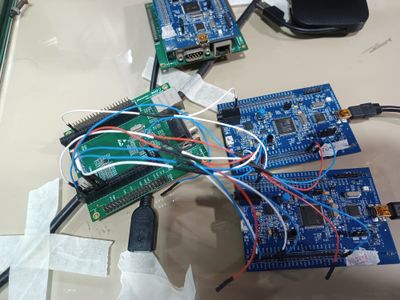

I am also facing the same problem, and I have not received any specific answers for it yet. However, my system is working fine with 1-bit SDIO. I am using the Discovery board of STM32F407VGT6 (DMSTF4BB - link). Additionally, I have noticed one more thing: even when using a 1-bit SDIO configuration, we still need to connect all four data buses (D0, D1, D2, D3) along with SDIO_cmd and SDIO_CK. Also, include the SDIO detect (GPIO input) on PB15 in my case.
20231127_122039.jpgapart from this I am also facing issue as "
I am currently working on a project that involves integrating USB functionality for data transfer and data logging on an STM32F407VG micro-controller. Specifically, I want to log data files on an SD card and enable the user to download these logged files from the SD card via USB. Additionally, I'd like to allow users to copy files from their PC to the SD card via USB, all through the STM32F407VG using the SDIO communication protocol.
I'm facing a challenge in making the USB_OTG_FS (On-The-Go Full Speed USB) and the SD card (using FatFS) work together seamlessly. I would greatly appreciate your guidance and any insights you might have on how to achieve this integration.

please go through my code (atteched below) and let me know what to do? and how to integrate USB and SD card simultaneously?
my observation: I took two STM32F407VGT6 microcontrollers and connect them the to same SDIO
source it(setup) is not working when both boards are powered on but when USB and FATFS works fine seperatly the problem is in two pins (PC10 and PC11) D2 & D3 please give me solution for the following:
  1. How do I configure USB_OTG_FS as a USB Device in STM32CubeMX or other development tools?
  2. What are the essential initialization and setup steps for using the USB_OTG_FS as a USB Device alongside the FatFS library for SD card communication?
  3. Are there any sample code snippets or project examples that demonstrate this integration?
  4. What should I be mindful of when managing the data transfer between the USB and SD card to avoid conflicts or data corruption?
Can you please specify !!

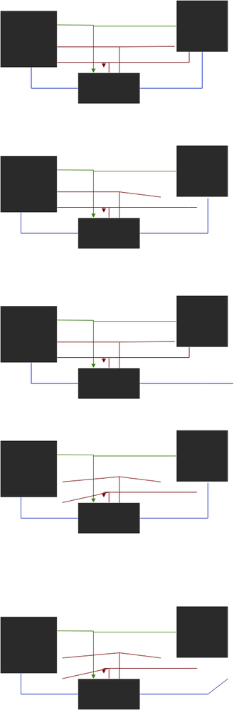

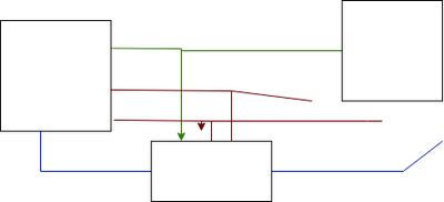

I am still facing issues in my project. I want to use USB functionality, but I am unable to do so due to a problem with SDIO pins PC10 (SDIO_D2) and PC11 (SDIO_D3). I am trying to connect two STM32F407VGT6 microcontrollers with the SDIO pins of the same discovery board (DM-STF4BB). We have uploaded USB (device-Mass storage device) code in one microcontroller, but that code only works when PC10 and PC11 pins are not shorted/connected. It doesn't matter if the second board is powered or not; connecting these two pins will always create a problem. And I want design a PCB in which only single controller will be powered at a time please guide me what to do, we can not use shottkey diode in PC 10&11 and VCC  because of voltage loss, will MOSFET work ?
Consider the two red lines as PC10 and PC11 (D2 and D3 respectively), green lines as other SDIO lines with ground, and blue lines as VCC. Two squares represent STM32F4, and the rectangle below represents the SDIO device with an SD card.
code is uploaded in first STM32 on the left side
USB and FATFS functionality will only work in the following configuration
where as the USB will not even detect by any of the following configurations:
