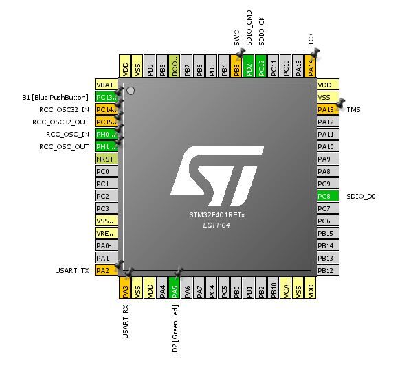

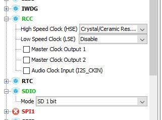

I've been trying to get an SD card working in 1bit mode using the SDIO peripheral. I am failing, and would appreciate some help. I'm on a Nucel401RE using STM32Cube_FW_F4V1.180.0
The pin configuration is below. I have not enabled anything else

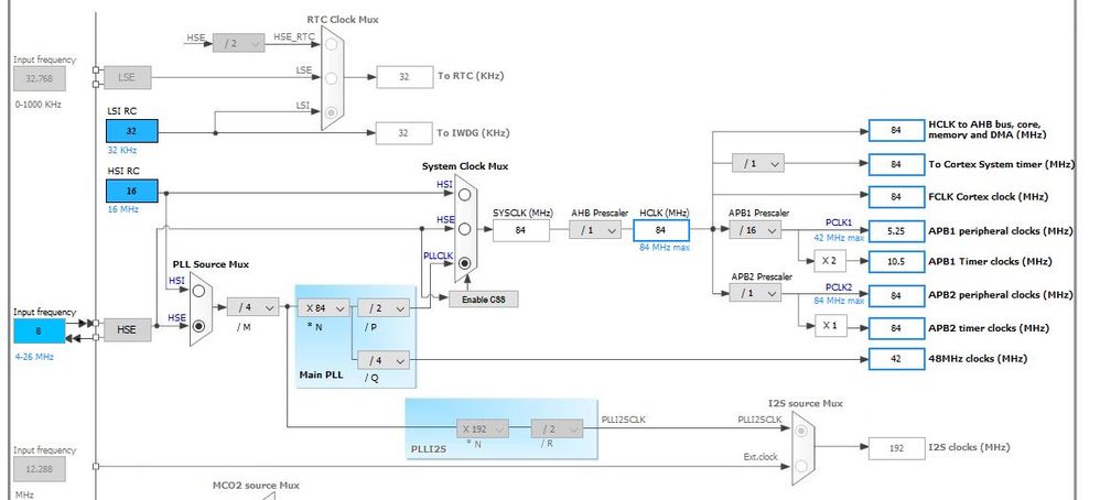

My clock configuration is below. I've not configured anything else - including any interrupts. (sorry for the small font HCLK is 84 Mhz)

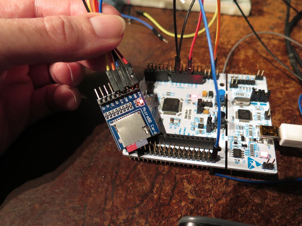

SDIO_CMD, SDIO_CK, and SDIO_D0 are connected as you might imagine. The breakout board includes some pull ups.

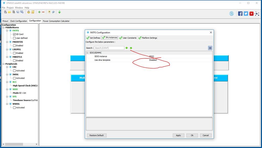

Problem now solved, I needed to set Stm32Cube\Configuration\FATS Configuration\IPs instances\Use DMA template to 'disabled' - and then it worked!

Can you explain where/how you disabled this '
Use DMA template'?
Posted on December 04, 2017 at 22:39
You'll find it in STMCube, go to the configuration tab, and choose the configuration for the FATFS, and then it's in the second tab along (IP Instances)
Posted on December 04, 2017 at 22:50
Ok, that's what i thought you meant, but i don't have that on my cube!
Upgrade time.
Curious, when it was setup disabled, did you have DMA setup in the SDIO configuration?
Posted on December 04, 2017 at 23:25
I was trying to keep the project as simple as possible, so everything was at it's default values (i.e. I didn't do anything to enable DMA that didn't happen automatically)
