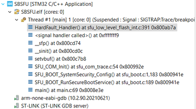

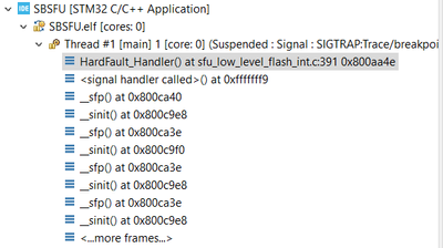

I connected debugger and every time programs ends up in a hard fault handler...
With SFU_MPU_PROTECT_ENABLE turned off:
With SFU_MPU_PROTECT_ENABLE turned on:
First debugger starts here
Then it fails upon calling SFU_BOOT_SystemSecurity_Config() -> SFU_COM_Init() -> setvbuf():
If necessary I can provide snippets of code. Thanks!

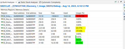

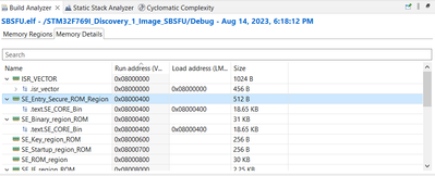

‎2023-08-14 9:33 AM
Thanks! I didn't solve the issue but did help finding this out:
That's the information from built in build analyzer for SBSFU.elf. I have no clue why SE_Entry_Secure_ROM_Region is that huge occupying 3729% of allocated memory.
‎2023-08-14 9:44 AM
3729%
Went a little over the top :grinning_face_with_sweat:
‎2023-08-14 9:47 AM
Just a little bit :D
I would like to know why since we are stuck on it for a long time. I saw similar thread on that forum but nobody replied to it.

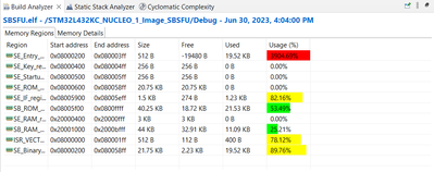

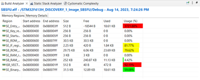

‎2023-08-15 4:07 AM - edited ‎2023-08-15 4:15 AM
Okay, so that's weird, but I built two different sample projects:
- NUCLEO-L432KC (1_Image)
- STM32F413H-Discovery (1_Image)
Both presents same misleading information that there is some issue with memory mapping. The thing is that NUCLEO-L432KC works totally fine. Looks like it's not an issue with the build itself, but with the tool or naming used throughout linker files. Correct me if I'm wrong.
