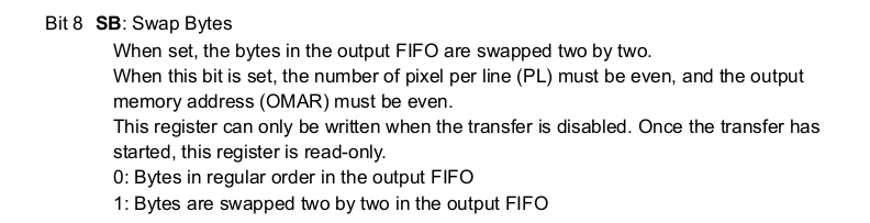

It seems that DMA2D_OPFCCR register SB bit described in the reference manual of the the STM32H7 (RM0433, page 721) is not implemented. Code generated by CubeMX is missing the definition completely, an attempt to set the bit directly from code has no effect the bit remains 0:
hdma2d.Instance->OPFCCR |= (1 << 8);
Also tried:
hdma2d.Instance->OPFCCR |= 0xffffffff;
Resulted in 0x300007
It seems that only RBS, AI, CM are implemented...
What could be causing this?
Is this a mistake in the reference manual?
Has the byte swap function of the output FIFO been omitted?

This is fine for static artwork, which could be formatted this way. However we are planning to use DMA2D to render texts and alpha blend images. Looking at the RGB565 definition of the DMA2D (RM0433, page 697)
byte0: G0[2:0] B0[4:0]
byte1: R0[4:0] G0[5:3]
byte2: G1[2:0] B1[4:0]
byte3: R1[4:0] G1[5:3]
RGB565 little endian (right?). It seems that the even and odd bytes need to be swapped before they can be sent to the dispay. The SB bit of the OPFCCR register promises to do just that....

Unfortunately the output rgb565 of DMA2D is swaped.
I saw the SB bit of the OPFCCR register in the reference manual but unfortunately this bit is not referenced in CubeMX and seems useless if i set the bit directly.
SB is described in RM0433 rev 6 page 732.
Does anyone know anything about it or used it successfully ?

I opened a support issue with ST directly as well, there was no satisfying answer from them, eventually that issue was closed by them with the remark that it had been open for too long.... It seems that ST customer support is trying to lower the number of pending issues by closing issues rather than solving them....
Anyhow, I personally think that it might be a hardware revision issue. If you look at old revisions of the reference manual, the swap bit wasn't mentioned in those, giving me the impression that the feature might have been added later on...
I eventually decided to add an extra MDMA pass to swap all the bytes in the framebuffer to the format that the display required at the cost of a few extra milliseconds of rendering time and extra memory bandwidth usage...
