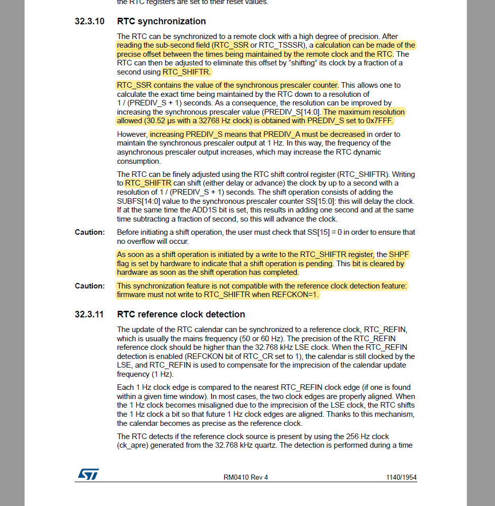

If you look at the last section of the STM32F7 Reference Manual RTC synchronization that tells you about how to advance or delay adding into SSR using SUB bits of SHIFTR.
