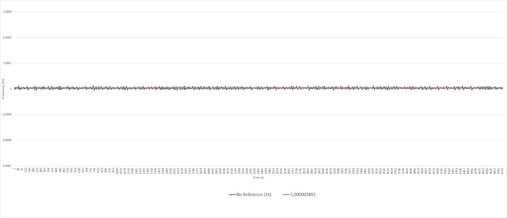

However, the results I get are much worse than without using the reference:
LSE only: 0.6s/day
LSE+50Hz: 7.5s/day
(test duration 4 days)
According to an4759, with the reference, you should get an accuracy of about 0.6s/month.

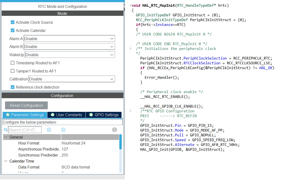

To perform the tests I have started a project activating the reference in CUBEMX, without any calibration.

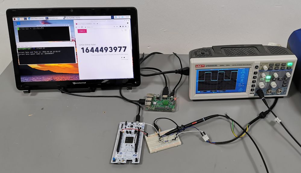

0693W00000JPqz8QAD.pngI have obtained the 50Hz signal with an optocoupled circuit, and I have introduced this signal by GPIO PB15 of the NUCLEO-413ZH.

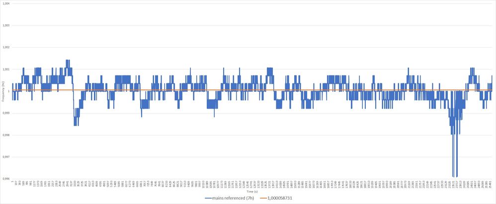

0693W00000JPr5FQAT.jpgTheoretically, the reference is working, the question is that it advances the time much faster than without the reference. Here you can also see the measurement of the 1Hz calibration signal measured with a "Frequency Counter".
0693W00000JPr8JQAT.jpg0693W00000JPr8sQAD.jpgIt can be seen how the reference mechanism is acting trying to adjust the 1Hz signal, but the average obtained and therefore the time delay, worsen.
What can I be doing wrong?

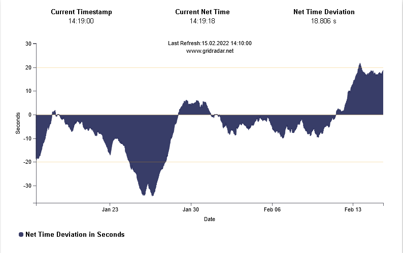

The mains grid frequency fluctuates, based on varying load and changes in supply; this is even more pronounced these days since the indiscriminate spread of the unregulatable pseudo-green power sources.
Here is an example "grid time" deviation graph for the mutually interlocked European grid (source: https://gridradar.net/en/net-time :(
0693W00000JPsdcQAD.pngso, for example if you would start your measurement at around 11.Feb and finished 14.Feb, with perfect locking to the european grid you'd see a >20 sec deviation.
