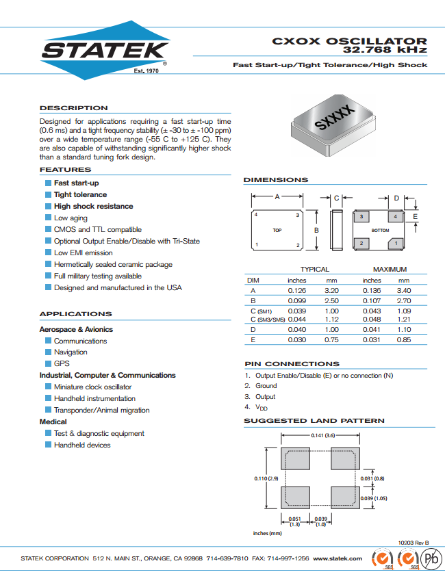

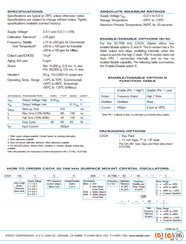

The oscillator I am using is CXOXHG4SE-32.768k/-/-/80/M. The calibration setting would not give me more than a few minutes and since these were working without drift before, I am not sure if this is the reason.

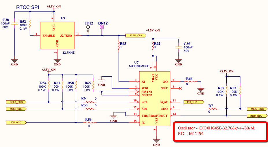

Let me summarize all observations again,there is some info that i missed to point to before. This will help pinpoint the issue.
1. When the circuit was built/tested. There is barely any drift observed on the RTC and works as expected.
2. First time we observed a drift was when the it was subject to a low temperature like -5C to +5C. In this case we observed that the drift was very high, it was actually more like a jump of like 4 seconds instead of 1 second.
3. We saw similar drift/jump behavior even with high temperature of > 130C.
4. Later as we kept using this circuit we observed drift even at room temperature.And this seems to be happening with almost all of these boards we had.
5. The drift seen in all cases is more than what the calibration setting can help fix, 20 days reflected as 26 days. At extreme temperature it was even worse.
At this points with all my observations I feel like there are 2 possible reasons.
1. My circuit seems to be causing damage to the RTC in someway. Cause it works wells at first ( few months) then seems to have issues.
2. Bad Batch of IC. All were boards were built with the same set of IC's.
Below is the circuit diagram.
2018-06-14 10:17 AM
So a fixed frequency source, with an ST part counting clock pulses, digitally, I'm hard pressed to see how the IC could be the cause of the failure here.
I wouldn't short XO to ground.
Couldn't find a PDF for the clock source.
No sure how accommodating the RTC will be to a rail-to-rail input. Haven't dug up an app note for that. Would probably expect AC coupling required.
2018-06-14 10:28 AM
XO can be disconnected from ground, luckily i just have remove R66.
Could not find a link, so attaching datasheet as images.

So I finally got this fixed. :)
Did a lot of reseach online yesterday to see what was the best way to connect clock source to an RTC chip. Went through examples of RTC chip connected to clock source felt that i should connect the clock source to XO instead of XI.
Will be testing the board at high temperature to validate that this is actually solved.
Here is what i did.
1. Disconnected the Xo from gnd.
- This reduced the drift from the original 1.3 to ~1.15.
2. Connected the clock input to the XO pin and left the XI pin floating and there was no drift now.
So to summarize this whole ordeal,
1. Connecting to XI works fine, no issues. Problems only show after using boards for sometime ( 2 months.)
2. on a bad chip, disconnected the clock source from XI and connect it to XO and problem seems to have disappeared.
A big thank you to Clive & Vitaliy for your inputs.
