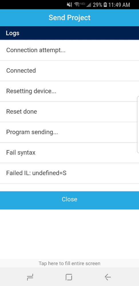

I have built and downloaded the FP_IND_PLCWIFI1 project to the NUCLEO-F401RE board using the IAR version.
I am able to connect to the WIFI, but when sending a project from the ST-PLC-Android app, a failure occurs:
What does this error mean?
Is there a work around?
Thanks,
Dave

Based on the error message, seems that the configuration you want to program is not correct.
Please could you share a print screen of the configuration you want to program?

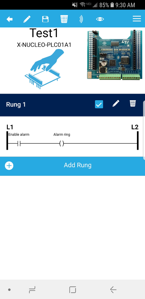

Here is a screen shot of the program I was trying to download:
Is there a document that explains the ''Send Project'' errors?
Thanks,
Dave

The error is related to the network decoding, but  based on the image seems that the net is OK, maybe there is something wrong in the component position or in the assignment of the component identification label.

However, I believe that error was caused by an incorrect 'Configuration type' selection: as you can see above, I had 'X-NUCLEO-PLC01A1' selected, but my actual configuration is 'X-NUCLEO-PLC01A1 + X-NUCLEO-OUT01A1'.  The project works fine with the correct Configuration type.
