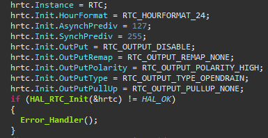

I'm currantly working on STM32G4 series and I had a problem. I initiate PC13 pin as GPIO_INPUT to read state from button. But It is possible to config this pin(PC13) such as RTC_OUT1. I config my RTC clock on Activate Clock Source to write and read actually time. When I write time to RTC I receive a clock source (1Hz) on pin PC13 and it is impossible to change it. I must turn off the device and wait a few seconds after that. I'm looked for what happend and I found that ST library(rtc library) modify registers on that way.
I'm never modify registers, so I'm confused that is it mistake on library or I do something wrong?
* I'm config RTC from LSE (32.768kHz) frequency.

Do you use Cube/HAL? Do you fully initialise the initialization structs before calling the clock setup functions?
How is VBAT connected? Maybe this is consequence of VBAT brownout?
I use Cube/HAL. This is my RTC initialization.
There is nothing complicated. On HAL_RTC_INIT we go to library on ST.

I currently commented this modifying registers and cuurently everythink working fine. But I'm not sure that changing library is a correct way, so I want to understand what happend there :)
waclawek.jan
Cube is open source, so you can debug it as any other code, to find out why does it write incorrect/unexpected values to RTC registers.
You can also place data breakpoint (a.k.a. watchpoint) to given register to find out where and what value is written to it.

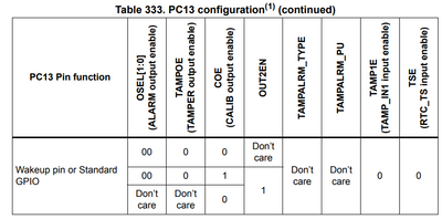

Ced
Hello @Mongolov ,
To enable the calibration output (" (1Hz) on pin PC13"), the RTC_CR_COE bit need to be enable.
In order to use the PC13 pin as standard GPIO you need to respect the condition given by the table 333. inside RM0440:
Maybe one of this condition is not ok.
 Best Regards,
Ced
waclawek.jan
Hi @Ced ,
Mongolov does *not* want to use PC13 as calibration output:
Hello @waclawek.jan ,
Yes, I understand the point.
Mongolov saw '(1Hz) on pin PC13.  So, I guess that is the RTC calibration output is enabled on RTC Output 1.
And to use the PC13 as the standard GPIO Pin (GPIO_INPUT) he need to follow condition given by the table 333.
Best Regards,
Ced
