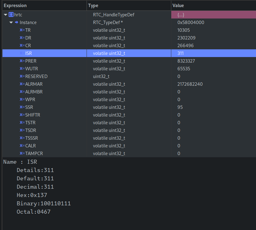

RTC Alarm EventCallback called only 1 time
Richard Lowe
Senior III
Working with the RTC I'm having some issue with the callback only being called a single time.
void HAL_RTC_AlarmAEventCallback(RTC_HandleTypeDef *hrtc) {
  RTC_AlarmTypeDef sAlarm;
  uint32_t hobb_time;
  __HAL_RTC_ALARM_CLEAR_FLAG(hrtc, RTC_FLAG_ALRAF); // Does not seem to change the ISR register
  hobb_time = HAL_RTCEx_BKUPRead(hrtc, RTC_BKP_DR1);
  // Write the new hobbs incremented value to backup register
  HAL_PWR_EnableBkUpAccess();
  HAL_RTCEx_BKUPWrite(hrtc, RTC_BKP_DR1, ++hobb_time);
  HAL_PWR_DisableBkUpAccess();
  HAL_RTC_GetAlarm(hrtc, &sAlarm, RTC_ALARM_A, FORMAT_BIN);
  if(sAlarm.AlarmTime.Minutes > 58)
    sAlarm.AlarmTime.Minutes = 0;
  else
    sAlarm.AlarmTime.Minutes = sAlarm.AlarmTime.Minutes + 1;
  while(HAL_RTC_SetAlarm_IT(hrtc, &sAlarm, RTC_FORMAT_BIN) != HAL_OK){}
I have the alarm being triggered every 1 minute. I can see the alarmA flag and try to clear it with this macro:
But the ISR register is unaffected.
I've masked the DAYS, SECONDS, etc.
sAlarm.AlarmMask = RTC_ALARMMASK_DATEWEEKDAY|RTC_ALARMMASK_HOURS
                              |RTC_ALARMMASK_SECONDS;
sAlarm.AlarmSubSecondMask = RTC_ALARMSUBSECONDMASK_ALL;
Anybody working with alarm events that only trigger a single time?
The following lines will disable the RTC and cause all my issues:
The first line is already called in the RTC_Init() function, but the the last line, HAL_PWR_DisableBkUpAccess() will disable the RTC..... So that is why it was only called once.

I still have nothing. Seems like the HAL functions to perform all the actions called for in the datasheet.
  • Clear the interrupt on the Alarm
  • Clear EXTI interrupt
  • Write to protection registers
  • Re-enable the interrupt
ISR Flag does not clear:
Still can only get a single interrupt. Single alarm handler, that's it..... Please advise.
This is in HAL_RTC_SetAlarm_IT. Seems to include everything in the Reference Manual.
