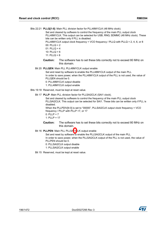

[RM0394 RCC documentation] typo in PLLPEN description
waclawek.jan
Posted on April 24, 2018 at 02:33
That it's a clock which could be used for SAI1 is explained above at PLLP; still, the signal's name is PLLSAI2CLK, however confusing that is.

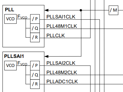

In fact, PLLSAI1CLK comes from PLL block and PLLSAI2CLK comes from PLLSAI1 block as described in datasheets.
This is done to differentiate the PLL sources.
So, to avoid confusion, we proposed tochange PLLSAI1CLK andPLLSAI2CLK in the reference manuals and datasheets bynew significant names.
