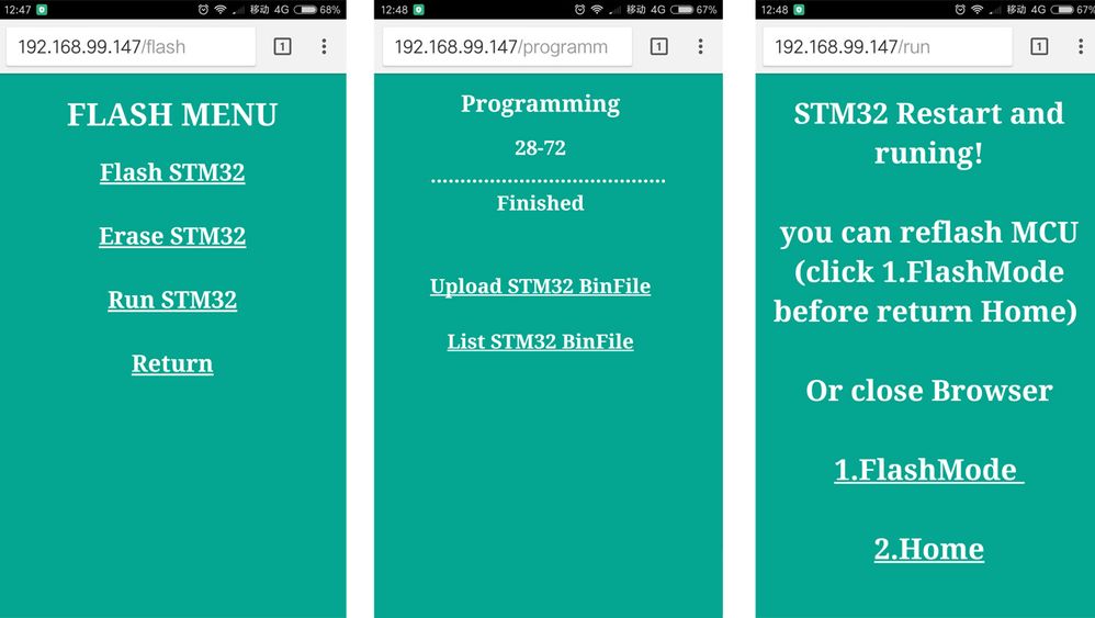

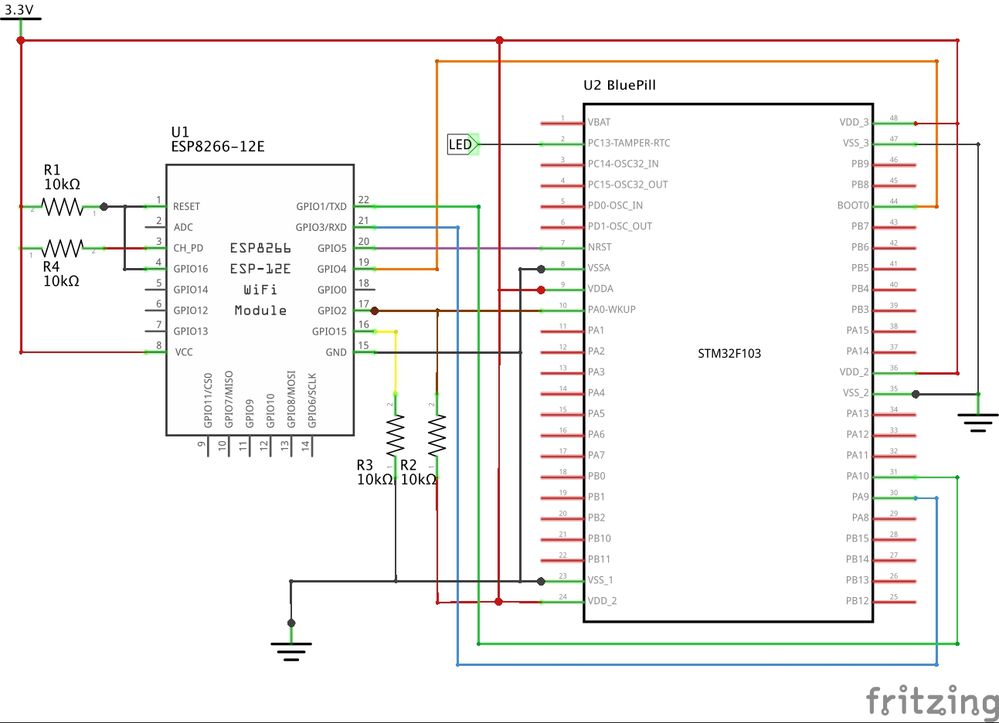

The current idea is to allow the user to update only during the development phase. An interesting alternative that I found is to use another MCU to perform the updates. For example use an ESP8266, which is compact and easy to implement. I found a project that does the programming of the STM32 via the serial port, and being able to use a smartphone to operate the ESP8266:
ESP8266-BluePill-OTA
Stm32-OTA-flasher02
https://github.com/csnol/1CHIP-Programmers
