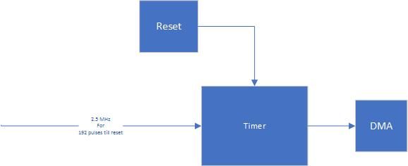

Essentially this is what my timer configuration is like. An input capture which triggers the dma every rising edge and then a slave mode set for reset.

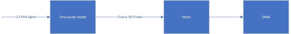

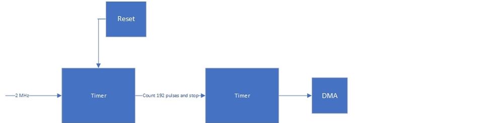

If I cant do this directly on the timer, is there a way that I could cascade two timers, where the timer would come in between the 2.5 MHZ signal and the timer that triggers the dma, pass through the clock signal and stop once 192 pulses have been received and restart on reset.Something like this:
I've tried a few implementations with cascaded timers and gated mode, but due to the gated mode not resetting the counter it doesn't seem to help. I've also found nothing on the forum but seen a few similar questions.

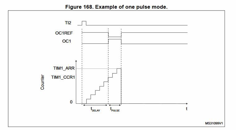

My understanding: one pulse mode would produce a pulse with a user fixed length and a repetition counter would produce N amount of pulses.
I think your referring to the following :
And looking at the reference manual:
I'd need to set the pulse length to 1 so it starts on the rising edge and stops on the falling edge of the input signal. The delay to 0 as I want no delay between the input and output pulse (Also enable fastmode by setting OCxFE).
I can't find much on the repetition counter for this mode, but I'm assuming it would produce 192 pulses at the output for 192 pulses at the input and then stop. Once the reset signal is received this process would restart?
