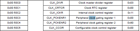

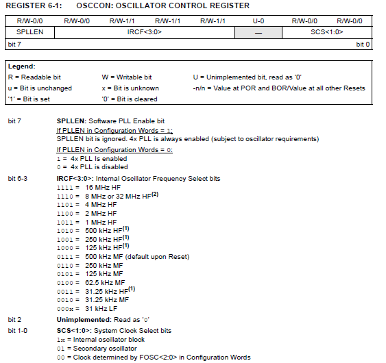

I would like to find this kind of information to know what is the value to configure the frequency of the internal clock for example:
But I only found this kine of information :
Without using libraries providing by ST there is no information about the content of registers.
