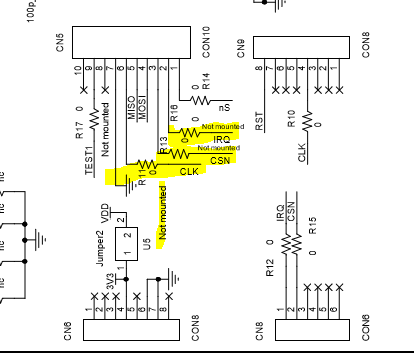

OK for the idea, a small rework to do on the board in this case.

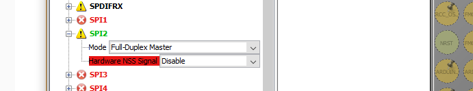

well ... using stm32cubemx we obtain :

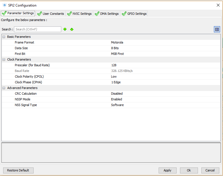

and the device configuration (limited spedd to ensure to have a compatible speed):
we obtain spi initialisation
hspi2.Init.Mode = SPI_MODE_MASTER;
hspi2.Init.Direction = SPI_DIRECTION_2LINES;
hspi2.Init.DataSize = SPI_DATASIZE_8BIT;
hspi2.Init.CLKPolarity = SPI_POLARITY_LOW;
hspi2.Init.CLKPhase = SPI_PHASE_1EDGE;
hspi2.Init.NSS = SPI_NSS_SOFT;
hspi2.Init.BaudRatePrescaler = SPI_BAUDRATEPRESCALER_128;
hspi2.Init.FirstBit = SPI_FIRSTBIT_MSB;
hspi2.Init.TIMode = SPI_TIMODE_DISABLE;
hspi2.Init.CRCCalculation = SPI_CRCCALCULATION_DISABLE;
hspi2.Init.CRCPolynomial = 7;
hspi2.Init.CRCLength = SPI_CRC_LENGTH_DATASIZE;
hspi2.Init.NSSPMode = SPI_NSS_PULSE_ENABLE;

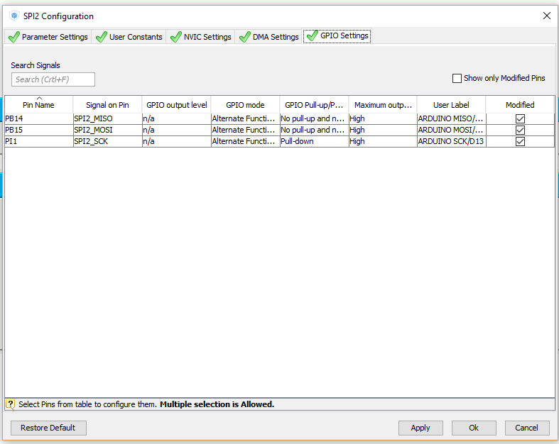

 and spi pin setup :
and pins configurations:
GPIO_InitStruct.Pin = ARDUINO_SCK_D13_Pin;
GPIO_InitStruct.Pull = GPIO_PULLDOWN;
GPIO_InitStruct.Speed = GPIO_SPEED_FREQ_HIGH;
GPIO_InitStruct.Alternate = GPIO_AF5_SPI2;
HAL_GPIO_Init(ARDUINO_SCK_D13_GPIO_Port, &GPIO_InitStruct);
GPIO_InitStruct.Pin = ARDUINO_MISO_D12_Pin|ARDUINO_MOSI_PWM_D11_Pin;
HAL_GPIO_Init(GPIOB, &GPIO_InitStruct);

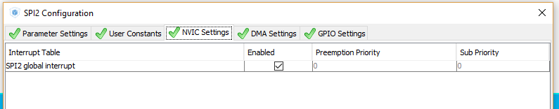

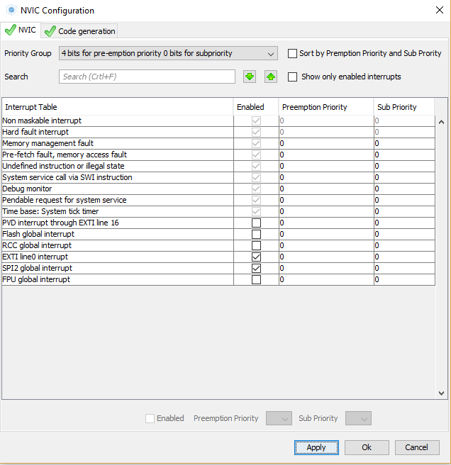

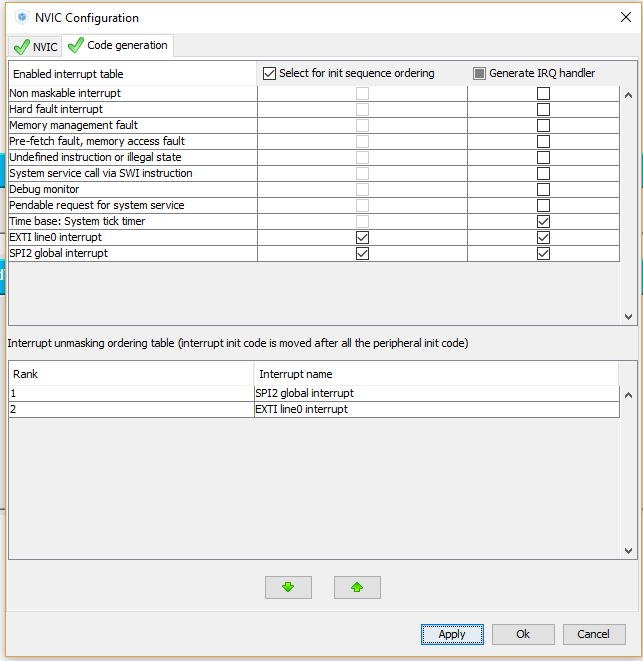

enabling interrupt:

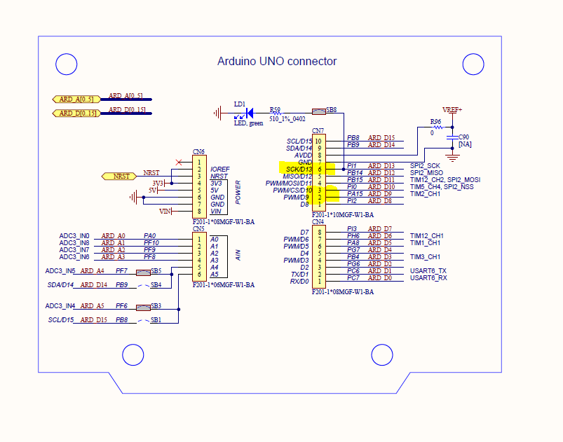

Posted on December 09, 2016 at 22:59

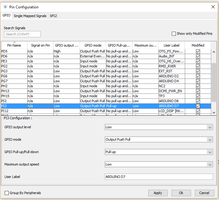

Arduino D7 (Reset pin) -> PI3
/*Configure GPIO pin : ARDUINO_D7_Pin */
GPIO_InitStruct.Pin = ARDUINO_D7_Pin;
GPIO_InitStruct.Pull = GPIO_PULLUP;
HAL_GPIO_Init(ARDUINO_D7_GPIO_Port, &GPIO_InitStruct);

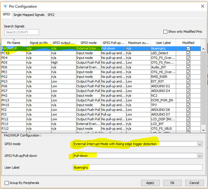

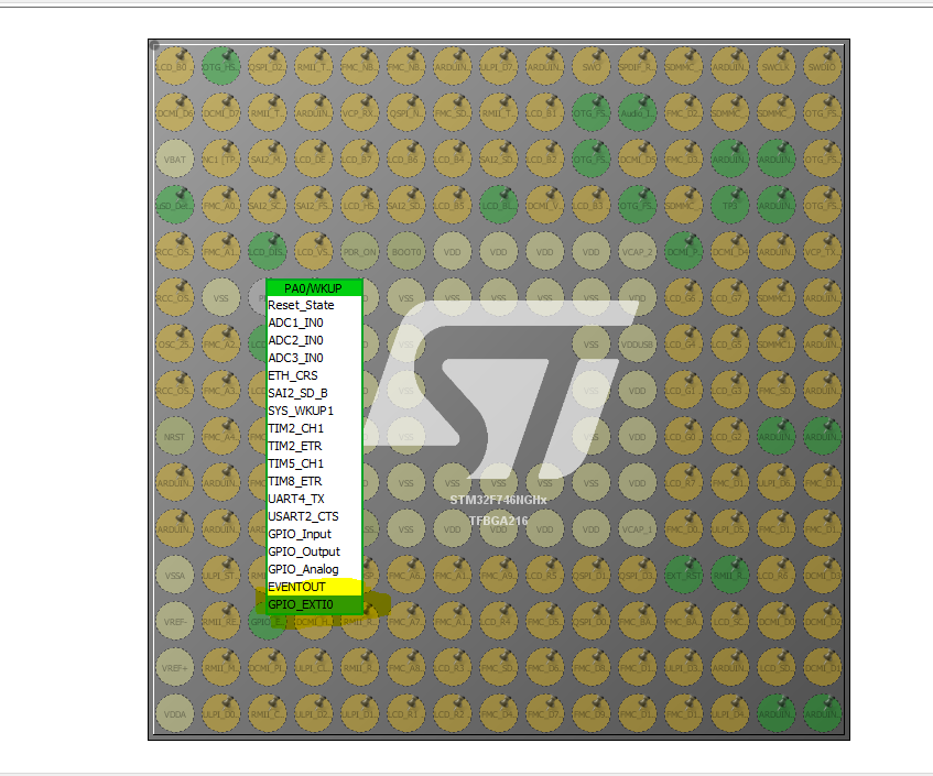

Arduino A0 (Irq) -> PA0
need to reconfigure the interrupt to suport irq
/*Configure GPIO pin : bluenrgirq_Pin */
GPIO_InitStruct.Pin = bluenrgirq_Pin;
GPIO_InitStruct.Mode = GPIO_MODE_IT_RISING;
HAL_GPIO_Init(bluenrgirq_GPIO_Port, &GPIO_InitStruct);

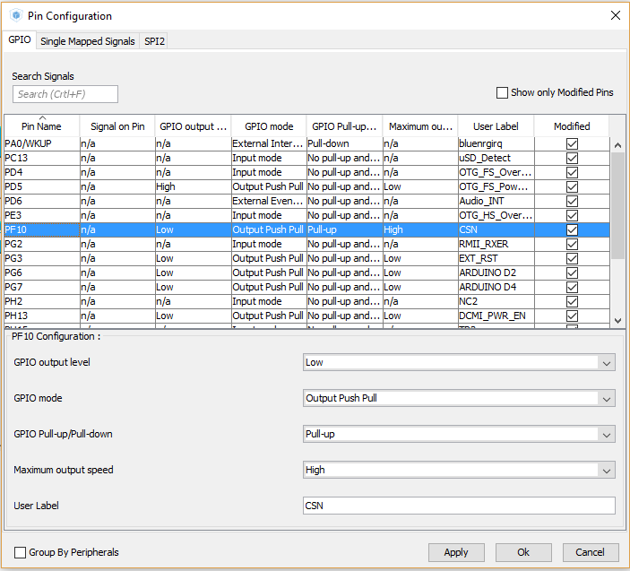

Arduino A1 (csn) -> PF10
/*Configure GPIO pin : CSN_Pin */
GPIO_InitStruct.Pin = CSN_Pin;
HAL_GPIO_Init(CSN_GPIO_Port, &GPIO_InitStruct);
and Interrupt 1 and 2 screenshot configuration
Arduino D3 (inital clock) to disable on the board or cut the pin on the shield to limit contact -> PB4 to ensure disabled
Adruino D13 to connect to Arduino D3 -> remove the led management in the original project.
