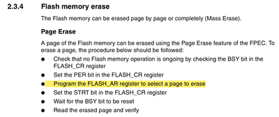

Regarding step 3:
Where does a page start? Do I need to specify the addres in FLAS_AR register to the begining of a page?

3) STM32D103C8T6 isn't a chip, but on the STM32F103C8T6, each flash page is 1K. The last page is page 63 which starts at 0x0800FC00. Steps to erase a page are in the programming manual.
PM0075.pdf

I've read the PM0075 manual already, but I am not certain about which address can I put there. Let's say I want to write at 0x0800FC02. What should I assign FLASH_AR with? Can I assing 0x...02 or shoud I always round up to 1kB and put 0x....00?
You put the start of the page in FLASH_AR. The 0x0800FC02 location is within the page that starts at 0x0800FC00.
