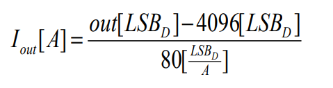

I've heard that floating point operations are very time consuming. However, I've seen that many STM32 include a floating point unit. I'm using a L432KC Nucleo. How does it exactly work? As far as I know, L432KC includes this unit which supports hardware floating point operations. I'm programming using CubeMx and SW4STM32 IDE. When I declare float and double precision variables, am I automatically perfoming this with the FPU?

The 'L4 has only a 32-bit FPU, so make sure you use only float not double. The constants involved have to be explicitly typed as float, best by 'f' suffix, eg.
float a, b;
a = b + 3.0f;

Thank you all. I have to use this formula to calculate the current. I don't need much precision.
Relatively small numbers, would be fine.
Where you'll run into trouble is you've got a number like 2 billion, and want represent/differentiate 2B+1 and 2B-1
