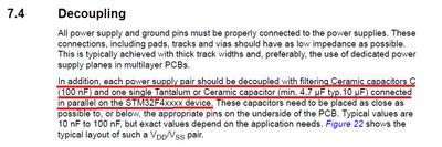

 This is what the AN4488 "Getting started with STM32F4xxxx MCU hardware development" is saying:
No need for that 0.1uF in parallel to 4.7uF.
Thank you very much for your response. In the 2.2 section of the AN4488 document you provided, I saw the attached figure. In the circled area of the figure, I think the N value is incorrect. I believe it should be (N-1) because 4.7UF occupies one pin. I verified my statement using the figure I took from the data sheet of STM32F412RGT6 (the second figure in the attachment).
