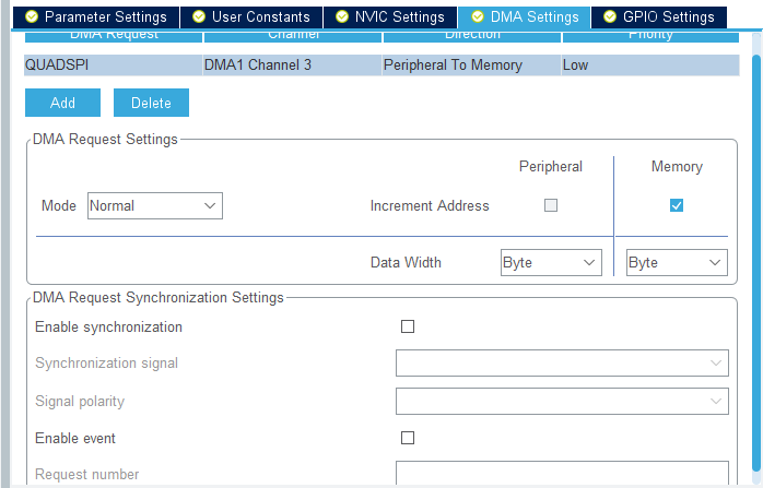

I'm trying to use QSPI to interface with a flash memory chip (GD25Q16). I can read and write to memory and status registers using blocking code, but I'd like to use DMA to decrease the CPU load. However, the QSPI handle's State gets stuck in HAL_QSPI_STATE_BUSY_INDIRECT_RX after the first DMA transfer. Manually resetting this state makes every QSPI xfer return HAL_ERROR instead of BUSY.
Additionally, HAL_QSPI_RxCpltCallback() is redefined in my code but never gets called; DMA1_Channel3_IRQHandler() (with HAL_DMA_IRQHandler() inside it) also never gets called.

I have DMA enabled in the Device Configuration Tool (DMA1 Channel 3, Peripheral to Memory, low priority, normal mode, synchronization and event disabled) with the QUADSPI global interrupt enabled, priority 5.
Thank you for any advice

‎2020-08-10 2:05 PM
I'm currently using a very slow clock for debugging so I know the issue won't be the clock's fault. I previously had the prescaler set to 5. Going slower shouldn't cause any issues (and I just retested it with a prescaler of 5 to be sure and got the same results).
Using DMA with 1 byte is just for testing; once I know I can actually use DMA to change a single byte, I'll likely go back to blocking mode for things like the status registers. However, writing thousands of bytes at a time will require DMA.
All I did to enable interrupts was check the QUADSPI global interrupt box in the device configuration tool. I believe that's all that was required for other peripherals using DMA.
Also, these lines are created in the NVIC initialization code:
HAL_NVIC_SetPriority(DMA1_Channel3_IRQn, 5, 0);
HAL_NVIC_EnableIRQ(DMA1_Channel3_IRQn);
Importantly, I've found that if I change the priority of 5 to anything less, then HAL_DMA_IRQHandler does get called.
