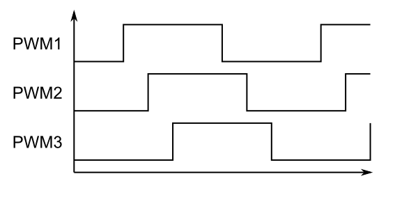

is it possible to configure the PWM Outputs to drive all three Channels with the same Dutycycle, but starting delayed (Phaseshifted)?
I configured the PWMs with a common Timebase TIM1.
Is there a chance to use a second timer to generate the delay, maybe by manipulating the countingregisters?

Well, your alternatives would seem to be using the toggle mode with CCRx placed at 120 degree shifts, or updating CCRx values actively during each CCx interrupt.

The thing to remember is each timer has a SINGLE counting element. If your speed requirements are sufficiently slow you can advance CCRx compare points in an interrupt, and control phase, duty and frequency. Toggle mode is particularly helpful here as it allows hard edge placement, and some latency in the interrupt processing.
I posted a toggle mode quadrature example recently, but that's two channels from a single timer with a 90 degree phase shift.

// STM32F4-Discovery TIM4 Triphase Output PD.12, PD.13 and PD.14 - sourcer32@gmail.com
#include ''stm32f4xx.h''
void RCC_Configuration(void)
/* enable peripheral clock for TIM4 */
RCC_APB1PeriphClockCmd(RCC_APB1Periph_TIM4, ENABLE);
/* GPIOD clock enable */
RCC_AHB1PeriphClockCmd(RCC_AHB1Periph_GPIOD, ENABLE);
void GPIO_Configuration(void)
GPIO_InitTypeDef GPIO_InitStructure;
/* GPIOD Configuration: TIM4 on PD12/PD13/PD14 LED */
GPIO_InitStructure.GPIO_Pin = GPIO_Pin_12 | GPIO_Pin_13 | GPIO_Pin_14;
GPIO_InitStructure.GPIO_Mode = GPIO_Mode_AF;
GPIO_InitStructure.GPIO_Speed = GPIO_Speed_2MHz;
GPIO_InitStructure.GPIO_OType = GPIO_OType_PP;
GPIO_InitStructure.GPIO_PuPd = GPIO_PuPd_NOPULL;
GPIO_Init(GPIOD, &GPIO_InitStructure);
/* Connect TIM4 pin */
GPIO_PinAFConfig(GPIOD, GPIO_PinSource12, GPIO_AF_TIM4); // PD12 TIM4_CH1 GREEN
GPIO_PinAFConfig(GPIOD, GPIO_PinSource13, GPIO_AF_TIM4); // PD13 TIM4_CH2 ORANGE
GPIO_PinAFConfig(GPIOD, GPIO_PinSource14, GPIO_AF_TIM4); // PD13 TIM4_CH3 RED
void TIM4_Configuration(void)
TIM_TimeBaseInitTypeDef TIM_TimeBaseStructure;
TIM_OCInitTypeDef TIM_OCInitStructure;
int Prescaler, Period;
Prescaler = ((SystemCoreClock / 2) / 360000); // ~360 KHz timebase, assumes APB1 H/4 TIMCLK4 H/2
Period = 36000; // ~10 Hz -> ~ 5 Hz
// The toggle halves the frequency
/* Time base configuration */
TIM_TimeBaseStructure.TIM_Period = Period - 1;
TIM_TimeBaseStructure.TIM_Prescaler = Prescaler - 1;
TIM_TimeBaseStructure.TIM_ClockDivision = 0;
TIM_TimeBaseStructure.TIM_CounterMode = TIM_CounterMode_Up;
TIM_TimeBaseInit(TIM4, &TIM_TimeBaseStructure);
/* Output Compare Toggle Mode configuration: Channel 1, 2 and 3 */
TIM_OCInitStructure.TIM_OCMode = TIM_OCMode_Toggle;
TIM_OCInitStructure.TIM_OutputState = TIM_OutputState_Enable;
TIM_OCInitStructure.TIM_OCPolarity = TIM_OCPolarity_High;
/* Don't want to set 0 or Period, but have 3 points at 120 degrees from each other */
TIM_OCInitStructure.TIM_Pulse = ((Period * 1) / 3) - 1;
TIM_OC1Init(TIM4, &TIM_OCInitStructure);
TIM_OCInitStructure.TIM_Pulse = ((Period * 2) / 3) - 1;
TIM_OC2Init(TIM4, &TIM_OCInitStructure);
TIM_OCInitStructure.TIM_Pulse = ((Period * 3) / 3) - 1;
TIM_OC3Init(TIM4, &TIM_OCInitStructure);
/* TIM4 enable counter */
TIM_Cmd(TIM4, ENABLE);
int main(void)
RCC_Configuration();
GPIO_Configuration();
TIM4_Configuration();
while(1); /* Infinite loop */
