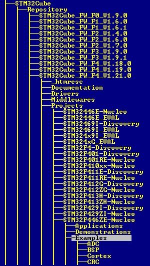

The HAL is provided with complete source code, and the code trees contain dozens of examples and demo applications, for dozens of boards.
Use a file manager, or static analysis tool of your own preference to navigates the available resources, find examples that closely match your goals and port to the target platform.
Posted on July 08, 2018 at 17:08
Do these sources get installed in accompany with the CubeMX? I can not find them in the installation path.
