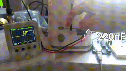

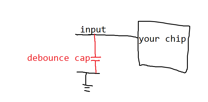

You can always add a capacitor in pararell with your input to debounce your signal. (harware low pass filter).
0693W00000Dq43yQAB.pngI used 220nF because it was a very strong mechanical bounce, you should try 10nF and maybe also a series resistance.0693W00000Dq42CQAR.gif
