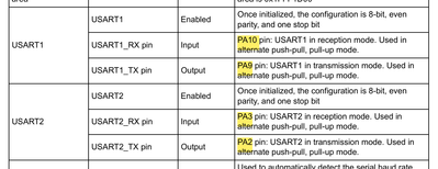

I plan to include a USART header and an SWD interface in the initial designs of my project. I understand that the STM32G030K6T6 microcontroller has two USART channels. Can both USART channels be used to flash the board via the built-in bootloader? Specifically, I intend to use USART2 for this purpose.
It's not necessary to connect NRST to the debugger. It's optional and generally not needed unless you are reassigning SWD pins.
Read AN2606 to see the pins supported by the bootloader.
Introduction to system memory boot mode on STM32 MCUs - Application note
