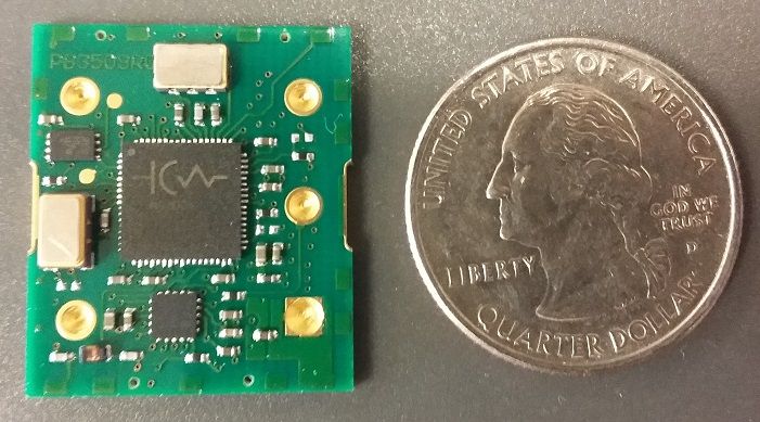

Hi Clive,
Thanks. I understand, GND and VDD are included. I also agree the Nucleo's STLINK is not ideal.
I just received a STLINK dongle, since I am tight on space, I designed a landing pattern for some pogo pins (cable from Tag-connect).
I soldered an STM32L0 on a breakout board. I am biassing/decoupling all VDD/GND. I pulled up reset, down boot0. I plan on only using the internal clocks.
I don't know why, but I can only connect when using the stlink utility, and the mode is "connect under reset".
Using the utility, I can program, erase. But using ST IDE, I cannot run the debugger.
The first time I try running I get the following message:
Waiting for debugger connection...
Debugger connected
                      STM32CubeProgrammer v2.4.0
ST-LINK SN : 003600453038510334333935
ST-LINK FW : V3J6M2B4S1
Voltage    : 3.24V
Error: ST-LINK error (DEV_CONNECT_ERR)
Encountered Error when opening C:\ST\STM32CubeIDE_1.3.0\STM32CubeIDE\plugins\com.st.stm32cube.ide.mcu.externaltools.cubeprogrammer.win32_1.3.0.202002181050\tools\bin\STM32_Programmer_CLI.exe
Error in STM32CubeProgrammer
Debugger connection lost.
Shutting down...
subsequent trials give me the following error:
Target no device found
Error in initializing ST-LINK device.
Reason: No device found on target.
only a power cycle (target and dongle) brings me back to the first error mode.
Thanks,
Ashraf
