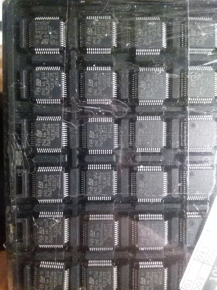

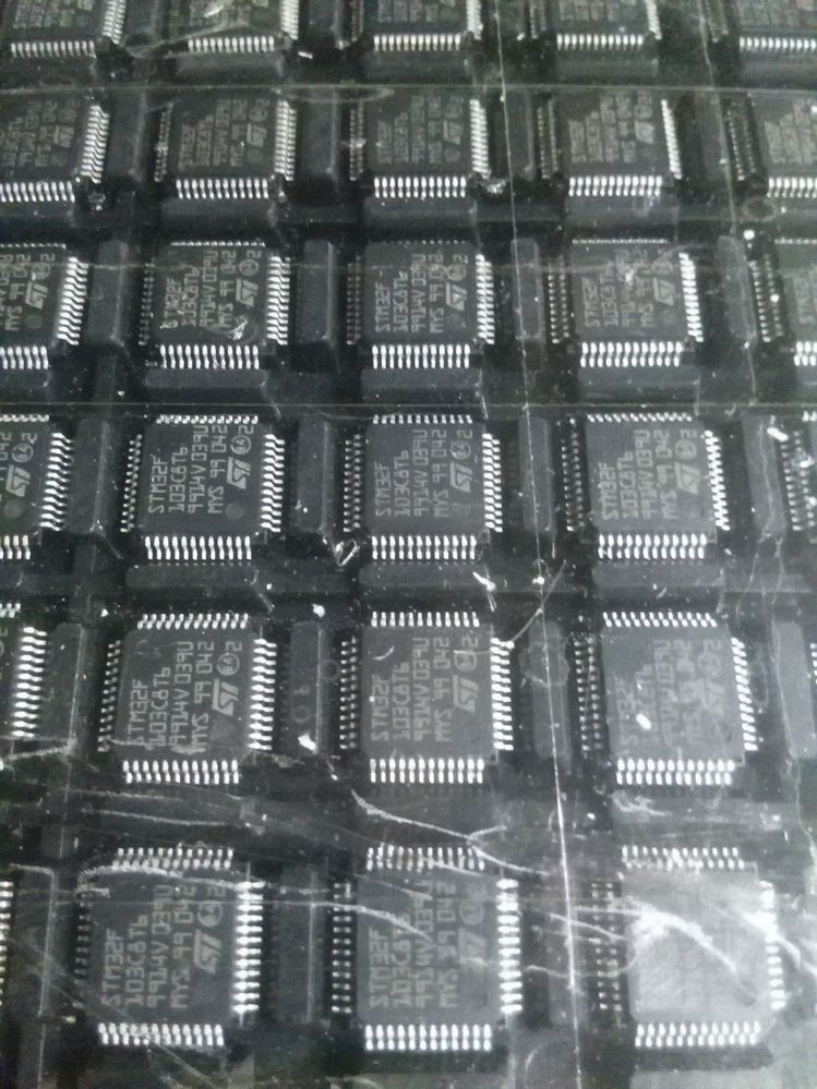

Adistrict
I tried this program on my bluepill and it works. Is this problem because of clone chips?(I think it's original)
Does the chips revision matter?!(I don't think so.) my bluepill chip's revision is X while the other one is Z.
I put some pictures here.
