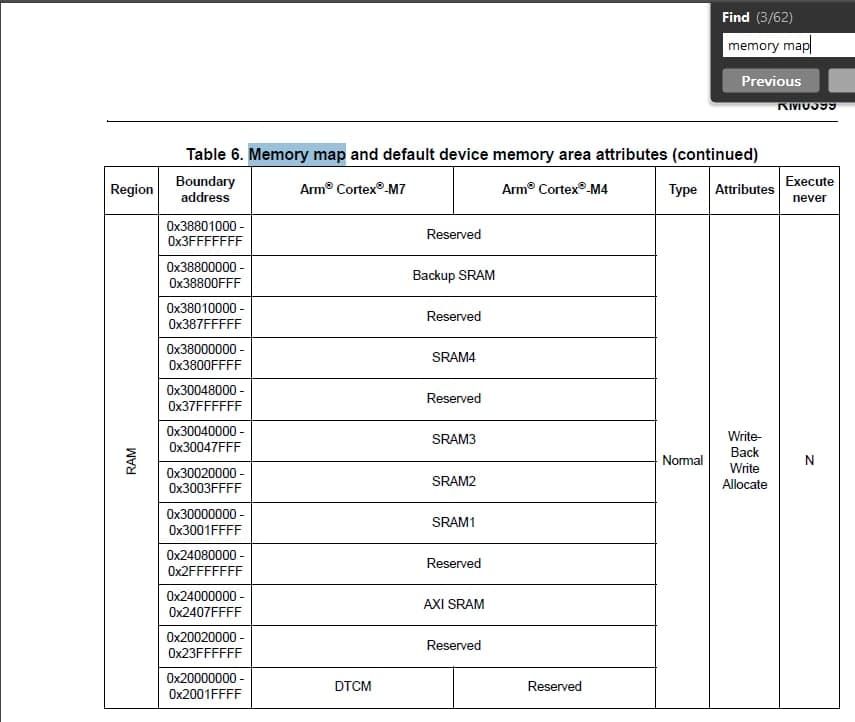

Hi every body! I chose STM32H755ZI MCU mainly because it has 1MB of RAM. In my project, I need to at least store 180 KB of Data. 45000 of float samples. I use the M7 Core which accesses the AXI RAM the size of which is 512KB; on the other hand, the Build analyzer shows the amount of RAM around 128KB and in STM32H755ZITX_FLASH.ld file the ram size is defined 128KB.
I decided to expand this area based on the memory file were presented in data sheet of the MCU but the program could not even be started and debugged. I got hard-fault error.
in STM32H755ZITX_FLASH.ld file the default memory setting was like this:

I thought that maybe if I change the RAM (xrw)   : ORIGIN = 0x20000000, LENGTH = 128K
to RAM (xrw)   : ORIGIN = 0x20000000, LENGTH = 256K and also change this line
_estack = 0x20020000; to _estack = 0x20040000; I may be able to expand the accessed RAM area.
Here is also the memory mapped file of my MCU:
0693W00000AMPYgQAP.jpg I would really appreciate if you inform me What is my mistake ?
Thanks in advance.
AXIMRAM (xrw)   : ORIGIN = 0x24000000, LENGTH = 512K
SRAM123 (xrw)   : ORIGIN = 0x30000000, LENGTH = 288K
5 REPLIES 5

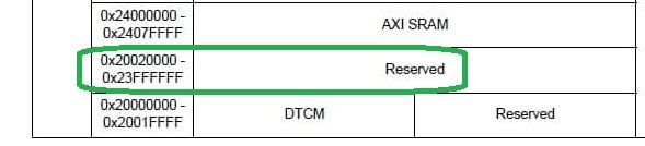

Doesn't it say 0x20020000 thru 0x23FFFFFF is reserved? DTCM being 128 KB

No I did not see such a message... I am pretty confused and have no idea where should I start from to solve this problem .... Maybe that is too much to be asked but could you please tell me more simple that what are the steps should I take to solve this problem ?
what should I do with the reset handler you sent me ?
 I think the problem I have is that I only access 128KB of Ram using M7 Core (based on what I see in Build analyzer and in STM32H755ZITX_FLASH.ld file). when I define global variables (three float arrays each of which has 15000 elements) I get RAM overflow error and when I define them In main ram overflow error disappears but after storing 12450 samples in RAM the program crashes and get the hard fault error. If I find a way so that I understand how can I use other bigger blocks of SRAM the problem will be solved. any idea :)?

Thank you Tesla. that was a nice reply! I changed the FLASH.ld file as you explained , which is presented as follows:

something that I forgot to take it into consideration was correct calculation of end of the RAM in my case it is : _estack = 0x24080000;  /* end of RAM */
previously, it was _estack = 0x20020000; this parameter should be changed in FLASH.ld and also RAM.ld file of the MCU. Now, everything works correctly and I could store the whole data into 512KB RAM which can be accessed by M7 core.
Thank you Tesla !
