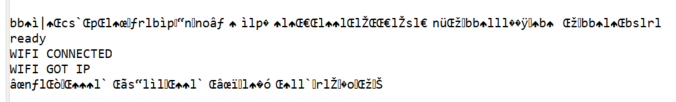

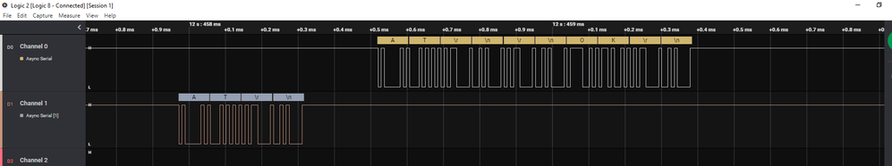

since some days I try to get a communication between a STM32F030R8 Nucleo and an ESP8266 WIFI module working. Communication between Putty and WIFI module works already. I am stucking at receiving the answers from ESP module. I already tryed it with interrupt or DMA and now simply with polling, but I can not read the answers from the module. I looked at the communication with my logic analyzer and saw, that the module seems to receive the AT command correctly and gives a correct response. All with the baudrate of 115200 wich I set for the interface.
0693W00000VOj2dQAD.pngBut all I receive, also with simple polling, is a "r", nothing else.

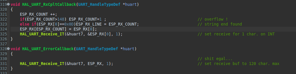

AScha.3
i needed ESP communication also; problem was: never know, length of string sended.
so i use the callbacks, on received char INT is started and i store new char to an array.
when line end coming, i set a signal -> global var to length of string.
then analyze string in main, IF var > 0 .
not so difficult...but need bigger array, because debug messages can be long...
and dont forget to handle error on receive !

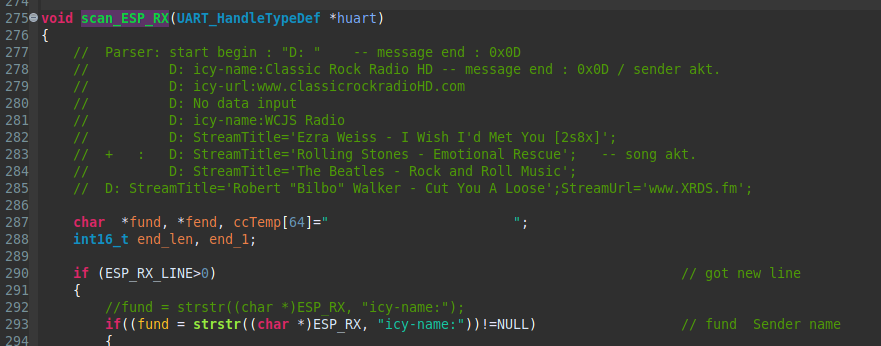

parser:
0693W00000VOjlnQAD.png...

Now I can see some answers of the ESP module like in console, but the answer for AT command is still random chars
Mister232
I just saw, that the whole output of the screenshot is dropped when the AT command is transmitted. In logic analyzer I can see, that the other outputs like "ready" or "WIFI GOT IP" are already received much earlier. But the output to console is only when AT command is transmitted

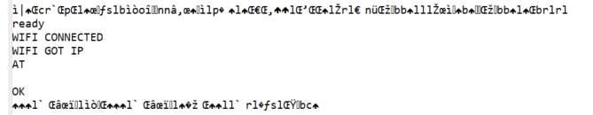

Now output looks like
0693W00000VOk59QAD.pngAt least OK is comming through now, but still some random symbols after it
AScha.3
well, i am tired now and cant see , what you doing wrong...
but:
  • you have the "error callback" ? must be.
  • INT priority...
_legacyfs_online_stmicro_images_0693W00000VOkBg.png-- because this random **** is after some wrong reception, so have spikes/stray on cable/line
-- need error treatment , maybe like i did : just wait for next

Mister232
Finally fixed it. Speeded up the baudrate to PC from 9600 to 230400 to get the transmission faster and now there are no random chars anymore except for the start of ESP module which is normal (boot output with 74880 baudrate). For normal operation I don't need the PC output, so I think it will be much faster than. Thank you for your good hints.
