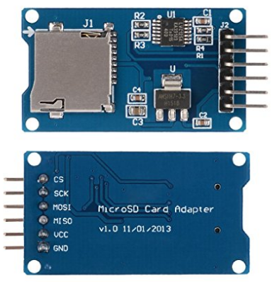

seems that I'm having many problems using the peripherals I need for my MSc Thesis project with the Nucleo-L432KC.
Now it's time to have problems with the microSD card module.
I bought this module:
https://www.amazon.it/gp/product/B01DRT4RU4/ref=oh_aui_detailpage_o00_s00?ie=UTF8&psc=1
I'm using the library SDFileSystem.h from
https://developer.mbed.org/cookbook/SD-Card-File-System

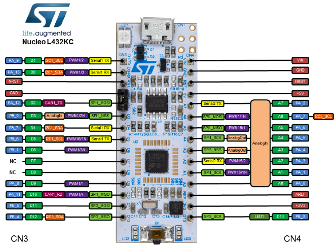

 and I tried the example program on my Nucleo-L432KC with these connections:
SD card module  |  Nucleo-L432KC
         CS           --->         D3 (SPI1_NSS)
         SCK        --->          A4 (SPI1_SCK)
         MOSI      --->          A6 (SPI1_MOSI)
         MISO      --->          A5 (SPI1_MISO)
         VCC        --->         +3v3
         GND       --->          GND
I'm using this
https://www.amazon.it/Kingston-SDC4-8GB-MicroSDHC-Adattatore/dp/B001CQT0X4
 formatted as FAT32.
I got the error message ''Could not open file for write''.
I also tried other connections, using
  • {D2 (SPI1_MOSI), D10 (SPI1_MISO), A4 (SPI1_SCK), D3 (SPI1_NSS)}
  • {D11 (SPI3_MOSI), D12 (SPI3_MISO), D13 (SPI3_SCK), A3 (SPI3_NSS)}
but I continue getting the same error message.

Adapter looks to expect 5V as it has regulator and level shifter.  Not sure I'd go that route.
Posted on May 12, 2017 at 16:45
I asked a question on the relative amazon webpage and they answer that the supply is 5 V. I tried connecting VCC to 5V pin but nothing changed: I got the same error message.

Those modules are garbage they have buffer from 3.3v to 5v. So they will work with Arduino and most likely won't with any nucleo. My suggestion: get SDIO modules or something on SPI that won't have crappy buffers etc. SDIO is much easier to get running you need around 5 mins to get it working with fatfs.
SPI is harder on stm32 there is a driver in BSP section under adafruit shield if you browse L4 HAL. It's obviously not plug'n play and you need to look at the code.

Check https://os.mbed.com/platforms/ST-Nucleo-L432KC/
It is mentioned there:
By default the PA_5 (A4) and PA_6 (A5) pins can only be used as Input floating (ADC function).
Remove SB16 and SB18 solder bridges in order to use these pins as Digital output and have access to other functions (DigitalOut, SPI, PWM, etc...).
