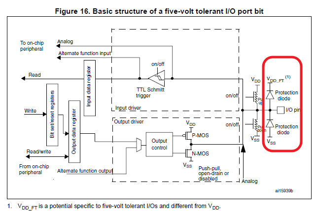

I am using the NUCLEO - L053R8 circuit board.
I question about 5 V tolerant function.
A pull-up resistor driven by 5 V is added to the port of PA_8.
In this case, when setting the open drain setting, 0.1 mA flows.
However, setting to input setting is 0 mA.
I want to set the current to 0 mA in the open drain setting state.
question 1
In the open drain setting, does the protection diode work?0690X00000607AWQAY.png
Question 2
Please check if my open drain setting method is correct.
It is set with mbed.

Max
Posted on May 31, 2017 at 04:43
If you turn off the
GPIO, you will not get the
LOW
level state anymore...
the current you are talking about only exists when the output is set to
LOW
level.
When the output is set to
OD
HIGH
level, the current is 0.
This current only depend on the external resistor value, if you don't have speed constraint, try to increase the value to reduce the current..
the protection works because there is an internal protection device - similar to a zener diode - between the internal protection rail
V
DD_FT
and
GND.
The mbed configuration looks right to me...

Let me ask you a question.
It is connected to 5V with an open drain pin sandwiching a 1.5K resistor.
(It pulled up with 1.5 KΩ)
The power supply of the CPU is 3.3V.
Even if it is in the open drain state, it will flow 0.23 mA.
This is thought to be the influence of the protection diode as in MAX's mail.
I do not want current to flow through the pull-up resistor in the open drain state.
With STM32 MCU, can not you do something like this?
Thank you.

Posted on June 01, 2017 at 05:20
Are you sure the internal pull-up or pull-down are disabled?
they are not compatible with 5V operation and create a path to Vdd.

Posted on June 02, 2017 at 04:13
It is self-follow.
Yesterday I reported that there was a problem with open drain setting on mbed.
I found a countermeasure.
I will show you how to deal with it.
NG example
&sharpinclude 'mbed.h'
DigitalInOut Common_7(PA_12);
int main() {
while(1) {
Common_7.output();
Common_7 = 0;
wait_ms(2);
Common_7.mode(OpenDrain);
Common_7.mode(PullNone);
Common_7 = 1;
OK example
int main() {
while(1) {
Common_7.output();
Common_7 = 0;
wait_ms(2);
Common_7.input();
Common_7 = 1;
Please set INPUT before setting open drain.
By doing this, I found that the internal pull - up resistor can be released.
I think that there is a problem with the mbed open drain setting library of STM32L053.
Please correct the STM32L053 library by all means.
