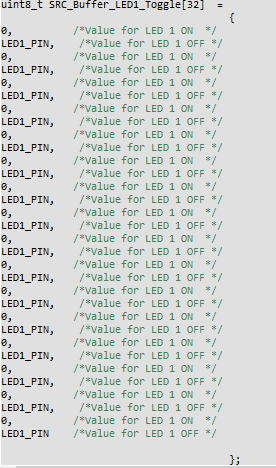

I started with this array.

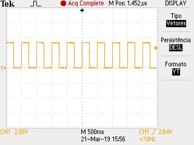

In the example, the BDMA is set to transfer two bytes in circular mode using this function 0690X0000088TKcQAM.png
In this case the program runs correctly and I get a signal like this (the idea is to get a square wave):

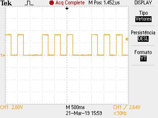

But when I change the function so it sends 8 values in circular mode,
the signal gets "corrupted" (I was expecting the signal to be like the one in the last capture):
I need this signal to not be "corrupted" with more than 4 elements because I need to send more than 240 bytes in a row.
I tried to see were the problem is but I am not having any luck.
