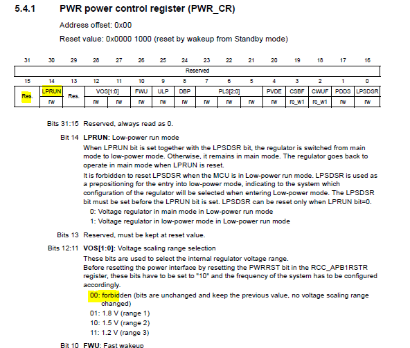

In fact, w
hen I use the __HAL_PWR_VOLTAGESCALING_CONFIG function with PWR_REGULATOR_VOLTAGE_SCALE3 for
a
low frequenc
y (lower than 4MHz)
, this instruction
stops the
execut
ion
, while this function is executed for the two other
ranges
(PWR_REGULATOR_VOLTAGE_SCALE1 and PWR_REGULATOR_VOLTAGE_SCALE2). I tried to change the value of this variable
(PWR_REGULATOR_VOLTAGE_SCALE3)
from
PWR_CR_VOS (
0x00001800
to 0x0000C000. With this setting, the function runs.
P
lease, is it possible to check if there is an error
in the
definition
of this value?

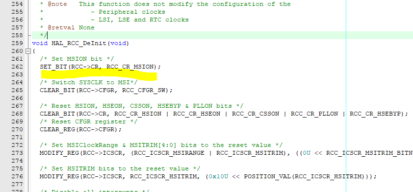

In the other hand
, the HAL_RCC_DeInit
function
does not execut
e
. Indeed,
the
execution
is stopped
in
the function of switching the SYSCLK to MSI
(CLEAR_BIT(RCC->CFGR, RCC_CFGR_SW);)
. When, I
change this function CLEAR_BIT
by
SET_BIT
function
and change the order of the 4
th
instruction (Reset CFGR register) before
the instruction switch SYSCLK to MSI, the code is executed and the sleep mode
outperforms
the normal mode
in terms of energy consumption
from
PWR_CR_VOS (
0x00001800
This setting leaves VOS unchanged , sets the reserved bit 15 and also sets LPRUN  bit14
For the second part of your question:
Please, can you verify if there are some problems in the function HAL_RCC_DeInit
It seems that HAL_RCC_DeInit function sets as systemclock the MSI , whithout check for MSIRDY flag in the RCC_CR register. Yes i thing this is a problem .

According to the RM0038 Reference manual, I agree with you that
changing the value of the variable
from
PWR_CR_VOS (
0x00001800
to 0x0000C000, leaves VOS unchanged, sets the reserved bit 15 and also sets LPRUN  bit14. But, the __HAL_PWR_VOLTAGESCALING_CONFIG function using PWR_REGULATOR_VOLTAGE_SCALE3 (0x00001800) stops the execution. Thus, I think that there is an error in the definition of this value.

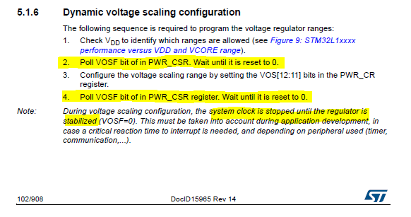

I checked the
__HAL_PWR_VOLTAGESCALING_CONFIG and according to RM sets or clears the VOS bits.
I will try later to find why stops the execution .I have a board with L152.

y (lower than 4MHz: 1, 2 or 4MHz), I found that __HAL_PWR_VOLTAGESCALING_CONFIG function using PWR_REGULATOR_VOLTAGE_SCALE3 (0x00001800) stops the execution. Please can you verify if there is a possibility that VOS[1:0]= 00 for range 3 and VOS[1:0]=11: forbidden (bits are unchanged and keep the previous value, no voltage scaling range changed)? Indeed, _HAL_PWR_VOLTAGESCALING_CONFIG function using PWR_REGULATOR_VOLTAGE_SCALE3 (0x00000000) is executed without any problem.

Posted on October 04, 2017 at 17:30
Hello again.
Does your code wait for VOSF flag?
If not , due to system clock stopping, your debugger will disonnect.
Take some care to follow theese note about change voltage scalling.
Regards
vf
