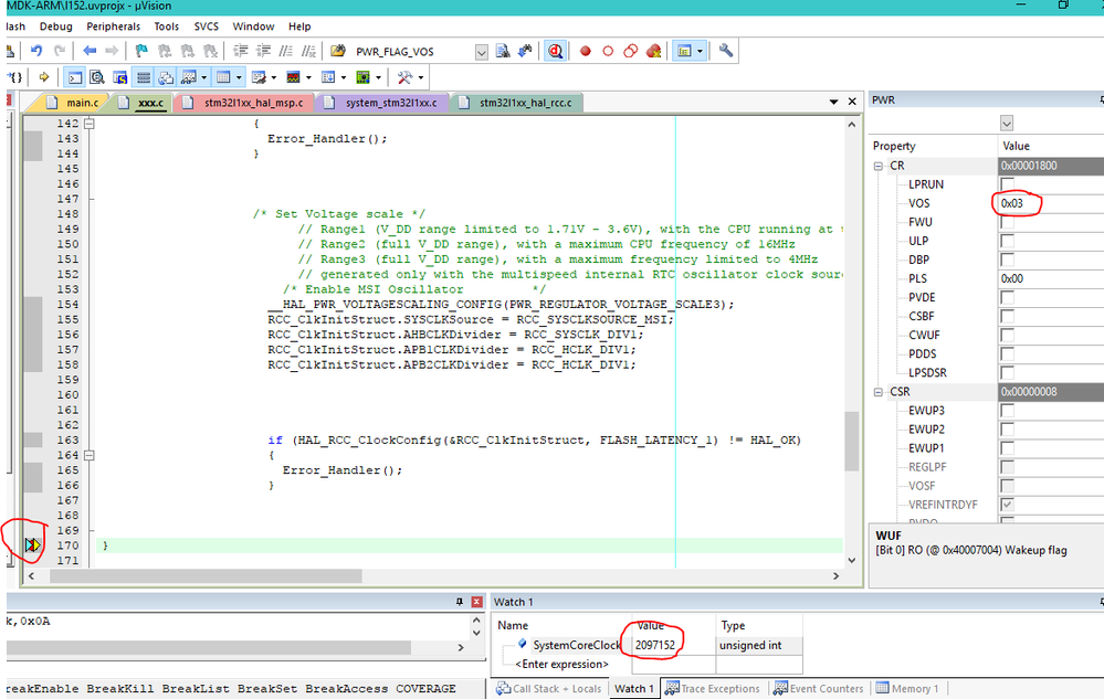

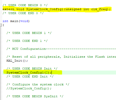

Hello !
I ran your code and i didn't faced any problem. I use
STM32CubeHALv1.8.0
and here are the results:
the code executed with 2 Mhz input.
Where exactly at your program occur this hang?
regards
vf

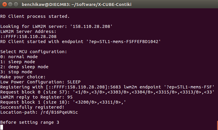

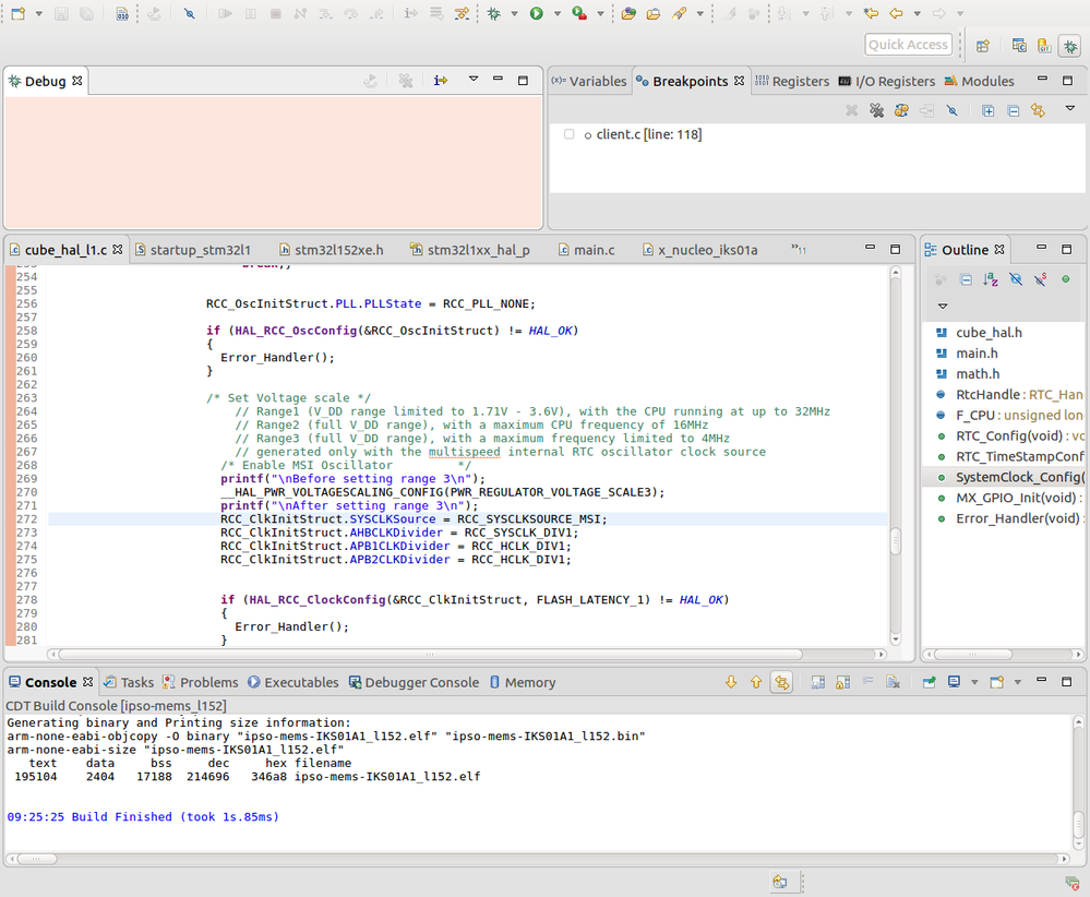

Posted on October 05, 2017 at 09:51
As seen in the following
print screen
, I have added two printf (one before setting range 3 and one after setting range 3). This is to verify if
__HAL_PWR_VOLTAGESCALING_CONFIG function with PWR_REGULATOR_VOLTAGE_SCALE3 is executed.
When, I run the main program and choosing sleep mode as low power mode, you can see in the following
print screen
that only the message before __HAL_PWR_VOLTAGESCALING_CONFIG function is shown which prove that this function stops the execution.
Best regards,
Wassim Ben Chikha

Posted on October 05, 2017 at 19:29
Hi Andrew
I noticed that when ran the  code with Keil. (previous post).
I found also inside HAL  stm32l1xx_hal_pwr.h this
I think tis explanation is logic enough.
