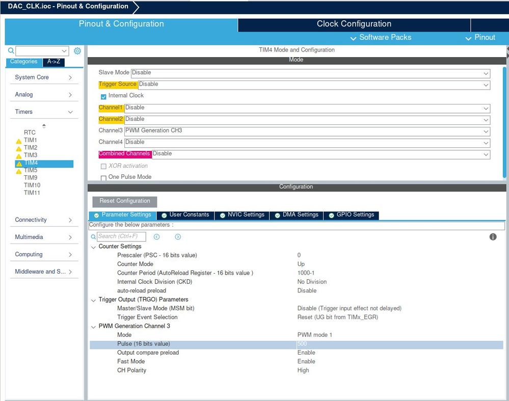

I want to read the data from UART and write it to the GPIO port which is connected to the 16 bit DAC.
I am facing problem as any UART1 or UART2 is not working when Timer interrupt is enabled.
100MHz CPU clock and 50MHz Timer 4 clock with the PWM output on Channel 3 of 12MHz, timer count 8 and pulse count 4. Using Half pules complete callback to write data on GPIo ODR registor. At the same time also receive data from UART. But the UART receive function is not working.
The timer interrupt routine is working but unable to receive data from UART. Is this due to the MCU is busy executing interrupt routine as this routine is call after every 16 CPU Clock cycles and thus that are no enough to execute UART Receive function.
What is the solution for this?
‎2023-07-06 12:47 AM
I Apologize for that.
Sorry I have missed multipler 2x which is before Timer clock on APB1 bus.
So Timer4 have 100MHz clock, So 1 Tick is 10ns.
As per my calculations for 12.5MHz T=80ns , so 8 Ticks gives us 80ns.
Therefore Counter Period = 8-1 and Pulse Value = 4.

Once I reduces the PWM CLK Frequncy by modifing Couter Period to 1000 Ticks and Pules Value to 500. UART can receive data and than Half Pulse Complete Interrupt writes this data to GPIOA->ODR and GPIOB->ODR registor.
Timer Config For 100KHz CLK

‎2023-07-06 12:45 PM
You are trying to generate a 12.5 MHz clock (via TIM PWM) and then write data to your DAC at that same 12.5 MHz rate? And have that data come from a UART?????????
Even ignoring the issue of the timer interrupt starving the CPU, you have a basic synchronization issue. How can you guarantee that you will always receive data from the UART before you need to write it to the DAC (i.e. don't underflow your buffer)? And how do you guarantee that you never get too much data from the UART (i.e. don't overflow your buffer or drop data)?
‎2023-07-06 10:44 PM
@Bob S wrote:You are trying to generate a 12.5 MHz clock (via TIM PWM) and then write data to your DAC at that same 12.5 MHz rate?
Yes
Yes
I haven't thought about these issues. Sugguest me what can I do from my side to solve these problem and get the DAC working and fulfill my requirement.
‎2023-07-07 10:07 AM
I can't/won't solve your system design issues for you. But here are some questions you need to consider:
- If you write 2 bytes to the DAC at a 12.5 MHz rate, how many bytes per second is that? How many bits per second would that require from your UART (for UART data, each "byte" takes 10 bit times to send)? Is your UART capable of receiving data at that rate?
- Do you really need to update the DAC at that rate?
- Does your data source (the other end of the UART connection) always provide a constant stream of data? Or is the data "bursty" (gaps between some of the data).
