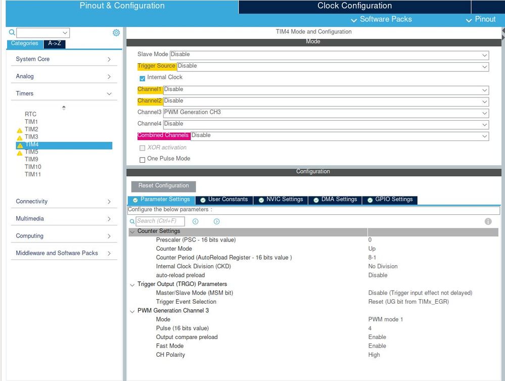

In your case, you are correct - your timer IRQ is starving the CPU.  I don't think your timer IRQ is really getting called every 16 CPU cycles - that is just not possible if the IRQ function does ANYTHING.  Just pushing registers on the stack and then popping them back off probably takes longer than that.
If your PWM freq is 12MHz and it counts to 8 before resetting/reloading, that is a PWM period of 12MHz/8 = 1.5MHz.  And an IRQ at "half complete" would be 2 PWM periods, or 0.75MHz (750KHz).  The CPU should be able to handle THAT interrupt rate, unless your callback has lots of code in it.

Oh man, THAT ^^^ is not correct.  Let me try again...  Your original post said:
> 100MHz CPU clock and 50MHz Timer 4 clock with the PWM output on
> Channel 3 of 12MHz, timer count 8 and pulse count 4.
Hmmm... 50MHz TIM4 clock with a (I presume max) count of 8 does not give you 12MHz PWM freq.  It gives you 12MHz/8 = 1.5 MHz.  And there is no way to get a 12 MHz PWM from a 50 MHz timer clock (would need to divide by 4.167.  So maybe divide by 4 to get 12.5 MHz?
So, yeah, as @Karl Yamashita said - post your code - UART and timer config so we can see what your PWM is really doing, plus your timer and dma IRQ callbacks and any code that deals with the UART.

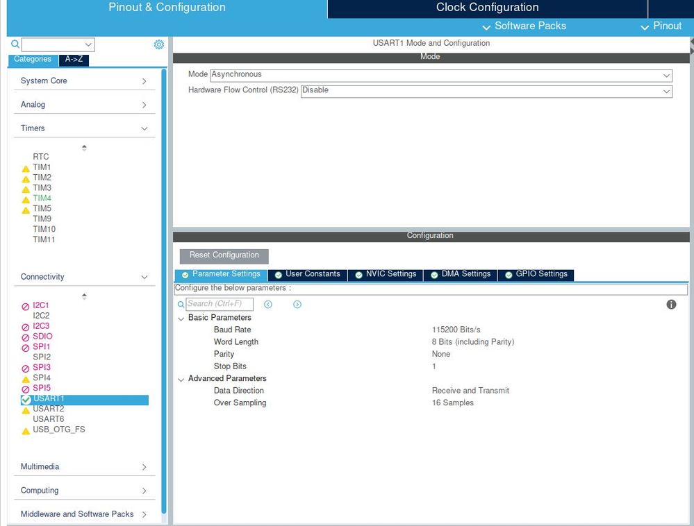

I think I missed the problem explanation, sorry for that.
Please find the detailed information below -
To Achieve -
1- Need to create DAC (Digital to Analog) Interface.

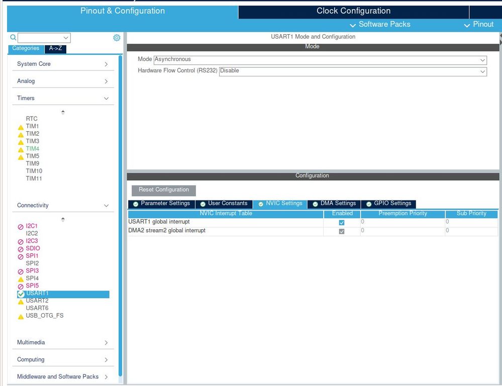

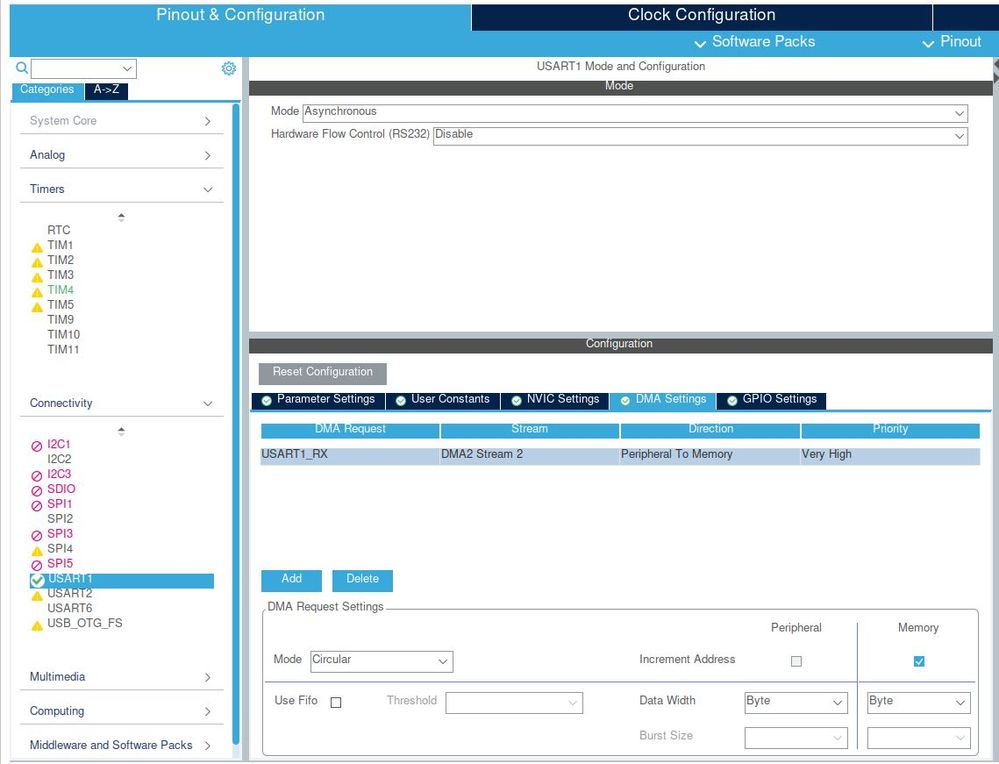

2- Receive data from UART ( I have chosen UART because of DMA support) (USB option is also available but I think DMA support option is not available on STCube IDE).
3- Send the data (received from UART) to DAC which is connected to GPIOA (A0 to A7) LSB and GPIOB MSB (B0 to B7)
4- Generate CLK of 12MHz / 12.5MHz.
Facing issues -

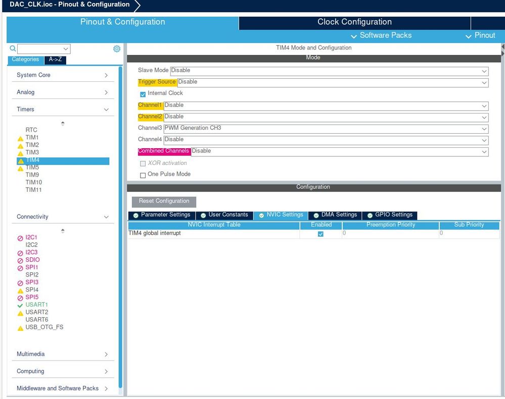

 1- Unable to receive data when the PWM timer interrupt is enabled (using this function in main.c file - HAL_TIM_PWM_Start_IT(&htim4, TIM_CHANNEL_3);
but , getting data when I disabled the PWM timer interrupt (HAL_TIM_PWM_Start(&htim4, TIM_CHANNEL_3);.

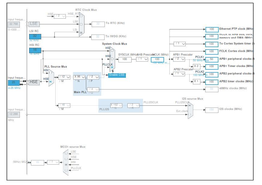

I have done calculation for timer 4 to generate CLK, the details -
APB1 Timer Clock :- 100MHz, so T=10ns.
1 Tick = 10ns, so for 12.5MHz, T=80ns.
Therefore Counter Period = 8 Ticks.
For 50% duty cycle Pulse value = 4.
Please see the reference image 01 -

I have used PWM output mode with timer 4 at channel 3 pin B8 for clock generation. On Half pules complete callback i write 16 bit data to GPIOA->ODR (LSB) and GPIOB->ODR (MSB).
Please find full details in reply section https://community.st.com/t5/stm32cubeide-mcu/problem-with-uart-transmission-while-timer-interrupt-is-enable/m-p/572482/highlight/true#M18951
Sorry I have multipler 2x which is before Timer clock on  APB1 bus.
So Timer4 have 100MHz clock, So 1 Tick is 10ns.
As per my calculations for 12.5MHz T=80ns , so 8 Ticks gives us 80ns.
Therefore Counter Period = 8-1 and Pulse Value = 4.
Please find full details in reply section https://community.st.com/t5/stm32cubeide-mcu/problem-with-uart-transmission-while-timer-interrupt-is...
I apologie for that. I am using UART with DMA. I have tried polling mode and Interrupt mode, but still unable to receive data.
