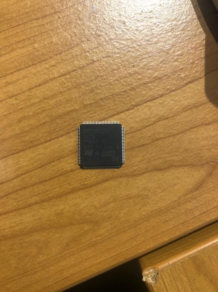

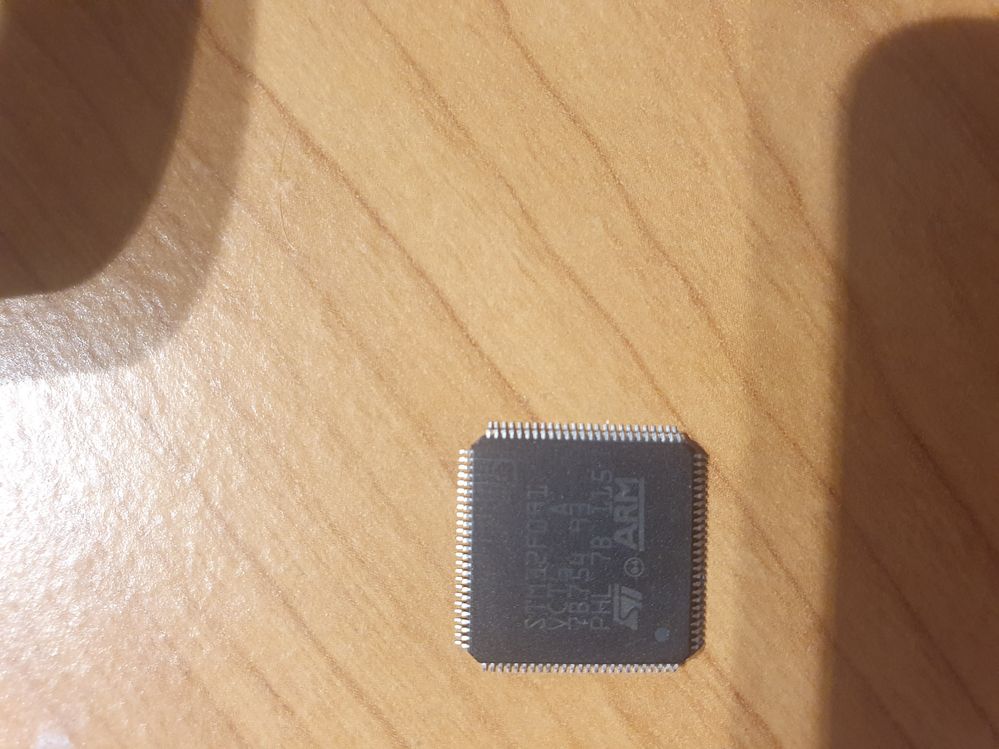

‎2022-09-14 2:49 AM
Can you join a picture of each MCU? And if possible the sales type.
I will indicate the manufacturing location.

‎2022-09-14 3:32 AM
Please find the both pictures, I hope you could read them. I have only my phone for photo today, but tomorrow, it will be possible for me with a microscope.
Correct MCU :
STM32F091VCT6 A
7B754 93
PHL 7B 115
Defect MCU :
STM32F091VCT6
992NX 93
MYS 99 146 A
‎2022-09-14 5:16 AM
Quality is good :)
I have to check some information internally, I will probably ask to get some data soon.
Normally this kind of drift is scraped in production.
