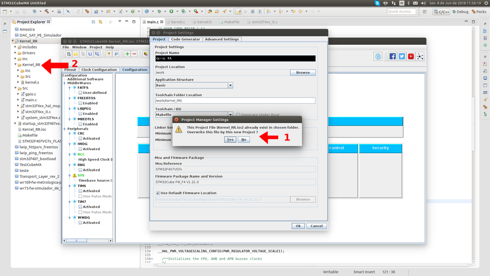

The problem found in STM32 Cube MX 4.26.0, is that the tool over-wrote the
files of my project..
I'll describe what happened:
1. My project I was working on was created with STM32 Cube MX 4.25.0..
2. I updated the STM32CubeMX.
When opening my project, and make some changes and then asked to
generate the source code.
A The first error message appears. Saying that there is a problem in the
Makefileproject file.
4. Changing the project settings, clicking the OK button displays the message
saying that my project already exists. And ask if I want to write over with a
new project.
The following is an image of STM Cube MX with error message [1]. We also
5. Clicking the ''No'' option, I can not implement my new settings.

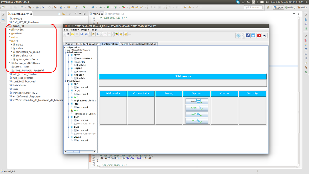

By clicking the ''Yes'' option, the STM32 Cube MX overwrites the articles with
a new project. In the following image shows the file structure of my project,
it is important to note that some files have been removed from my

Posted on June 25, 2018 at 18:33
Hi Evandro,
Thanks for reporting this issue, the regeneration of makefile will be fixed in a next release.
For the files overwriting it is a normal behavior as you created a 'new' project that is not aware of added user files.
Posted on June 28, 2018 at 13:27
OK!
on the overwritten files, a New Project was Not created.
I simply changed the project settings. Next, a source code was generated.
PLebe
The same problem:
  1. Project Settings -> Advansed Settings -> Change UART from HAL to LL.
  2. Message popuped: "This Project File (XXX.ioc) already exist is chosen folder. Owerwrite this file by this new Project?"
  3. Generate Source Code - all user files and user code removed.
How can I change peripheral driver from HAL to LL without project re-creation?
