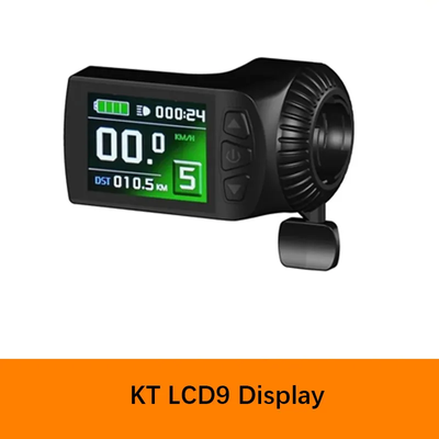

MSzła.1
I can't use SPI because the PCB is from an ebike computer. Exactly from the photo. They use the 8080 parallel interface to communicate with LCD
