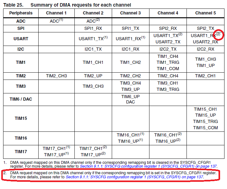

I cannot get DMA receiver on USART1 to working state. I'm attaching code and would be thankful for any help or advice. Are there anywhere some working examples with DMA? I must be missing something obvious....

RM0008 is NOT the controlling document for the STM32F0xx parts, that would be RM0091
For DMA1 Channel5 you'd need to change the DMA mapping in SYSCFG, normally I believe it would be DMA1 Channel3

thanks for response. Actually that comment was left in - my code is based on your examples... According to reference manual for f0xx, chanels 4 and 5 can also be used for USART1.
Yes, but repeating : For DMA1 Channel5 you'd need to change the DMA mapping in SYSCFG, normally I believe it would be DMA1 Channel3
/* Enable SYSCFG clock */
RCC_APB2PeriphClockCmd(RCC_APB2Periph_SYSCFG, ENABLE);
/* @arg SYSCFG_DMARemap_USART1Rx: Remap USART1 Rx DMA requests from channel3 to channel5 */
SYSCFG_DMAChannelRemapConfig(SYSCFG_DMARemap_USART1Rx, ENABLE);
