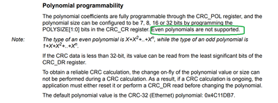

1 - I get a return error from HAL_CRC_Init(). Why does HAL layer only allow ODD parity polynomials?
/* Ensure that the generating polynomial is odd */
if ((Pol & (uint32_t)(0x1U)) == 0U)
status = HAL_ERROR;
2 - Am I missing something in setting up the CRC block?

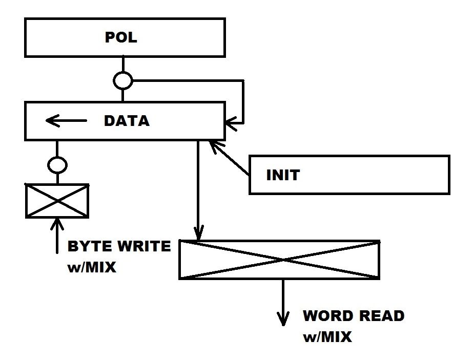

Mechanically I'm not sure the hardware has this limitation, it shouldn't need too.
Did some hackery that suggests it's not, where I did a 15-bit CRC/Polynomial
https://github.com/cturvey/RandomNinjaChef/blob/main/STM32_CRC15_CRC_CAN.c
The hardware is LEFT shifting
The initial value would be 0xFFFFFFFF and the result inverted to get the solution, right shifting.

Is suspect I can make the hardware work, but will take the polynomial being reversed, byte input reversed, answer reversed and inverted.

Dear @Tesla DeLorean @BradWalker ,
Thank you for the interesting exchanges, the main is reason is simply because our specification / manual say it.
here an example of our reference manual for STM32G4 series : STM32G4 series advanced Arm<Sup>®</Sup>-based 32-bit MCUs - Reference manual ,
Go to Page 456/2138 from Manual revision 8.
I fully understand it might work perfectly at your end , but from our side, we do not support the behavior or results as it could be never tested/verified as at industry level Odd Polynomials are the mostly used.
Hope it helps to clarify the topic.

Ok, but LFSR's and CRC methods have been a staple of DfT (Design for Test) / BiST (Built in Self Test) for over 4 decades.
I'm not sure of your CRC implementation here, but it's usually a net of feed back terms and flip-flops, gated by a latched polynomial pattern in this case, it should be able to be validated "by-design". Do you test all the other 2^(32-1) patterns for a polynomial that would be ODD? I'd wager serious money you do not, or come remotely close.
The CRC-24 implementation should be able to provide some robust test-patterns / test-vectors that could be applied at the DESIGN stages to exercise the gate level implementation. And prove robustly that the ODD rule is patently nonsense.
For the CRC-32-K I reversed the polynomial to deal with the left-shifting implementation, and that does make it ODD at the LSB.
But in the case of the 15-bit and 24-bit CRC that I've expressly demonstrated here, all the low order bits of the polynomial registers are zero, as I've left aligned them, whilst the CRC-24 itself is in the form x^24 + ... + 1

‎2024-10-13 5:55 AM
The feed-back path is 32-bit, the data always shifts left, the mixers optionally reverse / "invert" their data paths, allowing to simulate left/right shifting and msb/lsb insertion of the byte (as configured)
Now with non-normal sizes we can only inject bytes, you can't process 5 or 13 bits, for example, but you can have 3 or 13-bit CRC's. Configuration would allow for word insertion, but I think endian issues will still be frustrating.
