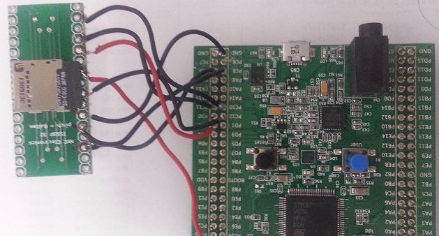

This is is very simple project, using stm32f4 discovery and wired microsd socket to read/write data to microsd card.
the code is generated by the stm32f4cubemx.
However error occurs at f_open, tracking down it shows FS_DISK_ERR in ff.c
Please help..

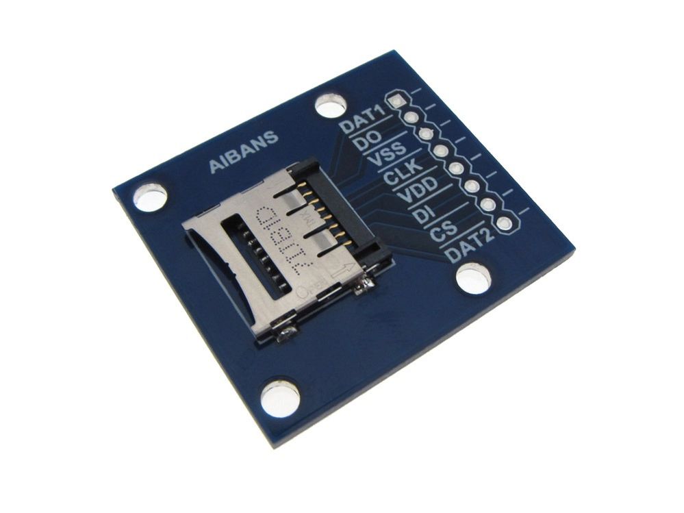

The board I am using is purchased from
http://www.ebay.com/itm/381265789938?_trksid=p2057872.m2749.l2649&ssPageName=STRK%3AMEBIDX%3AIT
And I am using this figure for pin assignment.
1. Resistor for D0-D3, and Cmd is 30k. I just pick up the close one I have.
2. The voltage is 3.0v. There is only 3v on the discovery board.
Thanks

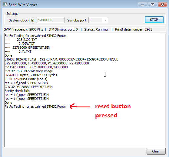

Posted on June 02, 2015 at 06:19
Just now, I retested it. The result is different.
It may be because of the connection problem of uSD card?
When I plugged in, it shows it can write. But after I push the reset button, it freezes.
Tomorrow I will try to use another socket board and test again.
Thanks
Posted on June 02, 2015 at 18:15
30K should be fine, I picked 33K as it's what I had to hand. My wire lengths were in the order of 1-1.5'' (25-40mm)
8 PC9 DAT1
7 PC8 DAT0/DO
6 GND VSS
5 PC12 CLK/SCLK
4 3V VDD
3 PD2 CMD/DI
2 PC11 DAT3/CS
1 PC10 DAT2

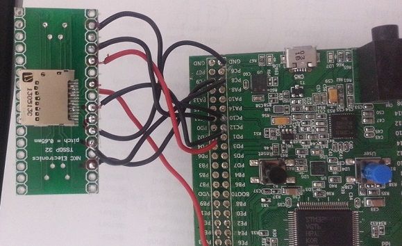

rwmao
Senior
Posted on June 02, 2015 at 22:10
Still getting the error after I resolder to another board using molex socket. I believe the connection is solid and perfect.
I usedmultimeter to checked the connection.

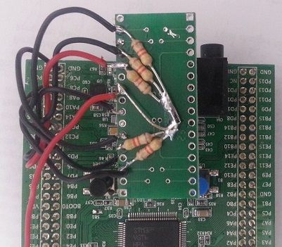

rwmao
Senior
Posted on June 02, 2015 at 22:20
backside of the board. 5 resistors(43kohm).

I suspect the wiring (length and layout) does not support ''higher megabit'' data rates.
Try scaling down the SDIO clock by one order of magnitude

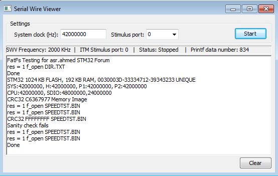

can you guide me how to implementSWV (Serial Wire Viewer) using SWO (Serial Wire Output) output without loosing the function of fprintf? I want to output debug info to SWV but I still want to access microsd reading/writing.
