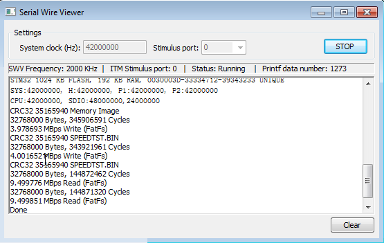

Hi Clivel
Update of the board.
I got a board  STM32F4DIS-BB from
http://www.newark.com/stmicroelectronics/stm32f4dis-bb/expansion-stm32f4-cortex-m4-for/dp/47W1731
Tested the connection. Clearly the error is caused by the connection problem,maybe signal interference .
I will move forward to test my own code.
Thanks Clivel.

Posted on June 16, 2015 at 17:29
I've published projects to the forum, there are a couple in the thread cited earlier.
I'm not sure what your sector 0 issue is, the sector should typically contain the MBR (Master Boot Record), which is nominally some boot code and a partition table.
